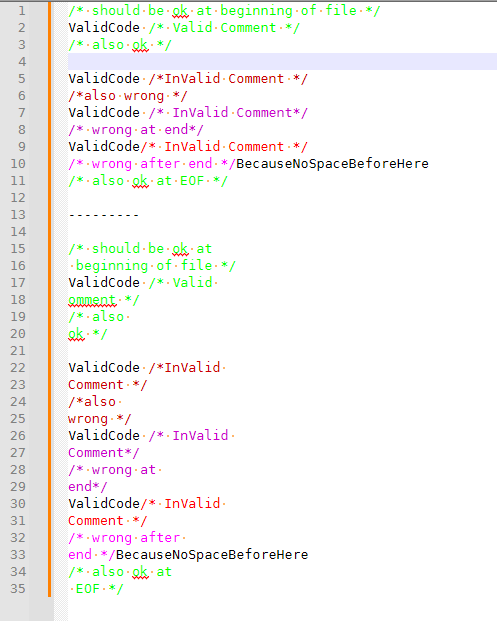

        Here’s what it looked like for me with the above definition:
        using “code”:
        /* should be ok at beginning of file */
        ValidCode /* Valid Comment */
        /* also ok */
        ValidCode /*InValid Comment */
        /*also wrong */
        ValidCode /* InValid Comment*/
        /* wrong at end*/
        ValidCode/* InValid Comment */
        /* wrong after end */BecauseNoSpaceBeforeHere
        /* also ok at EOF */
        update: to not highlight the B in BecauseNoSpaceBeforeHere, change the last regex to
        0xFF00FF = (?-s)/\*.+\*/(?=\S)

          Not being regex expert, what would I need to do so that multi-line comments are supported too?
            PeterJones @G A
            @G-A said in UDL comment that requires seperators:
            The (?-s) turns off the dot-matches-newline feature of regex; for multi-line comments to work, you’d need to turn it on instead, with (?s) at the beginning of each of the regexes shown.
            edit: but if you do that, you might need to make all the . matches “non-greedy” (not tested):
            0x00FF00 = (?s)(^|\s+)/\*\s+.+?\s+\*/(\s+|$)
            0x0000FF = (?s)(?:[^\s\A])\K/\*.*?\*/
            0x0000CC = (?s)/\*\S.+?\*/
            0xCC00CC = (?s)/\*.+?\S\*/
            0xFF00FF = (?s)/\*.+?\*/\S
            edit 2:
            … Hmm … when I don’t make it non-greedy, it doesn’t work; but if I make it greedy, it doesn’t work either.
            After some experimenting, replace the .+? or .*? with ((?!\*/).)+? or ((?!\*/).)*? – that way, it matches any character unless it’s the start of the comment-ending */
            0x00FF00 = (?s)(^|\s+)/\*\s+((?!\*/).)*?\s+\*/(\s+|$)
            0x0000FF = (?s)(?:[^\s\A])\K/\*((?!\*/).)*?\*/
            0x0000CC = (?s)/\*\S((?!\*/).)*?\*/
            0xCC00CC = (?s)/\*((?!\*/).)*?\S\*/
            0xFF00FF = (?s)/\*((?!\*/).)*?\*/(?=\S)

              Here’s the difference (regexes are my own, for illustrative purposes; colors are also not intended to match OP desire – again, my own, to illustrate):
              Greedy (?s)/\*.+\*/ has single match (the yellow) on whole thing:
              Non-greedy (?s)/\*.+?\*/ matches (shown in alternating colors):
                @Alan-Kilborn said,
                DEFINITELY!
                Yes, I discovered that when I started my testing after the first edit. I started the testing when I realized that probably non-greedy alone wasn’t sufficient, either. Hence the second edit, with the tested regex and screenshot
