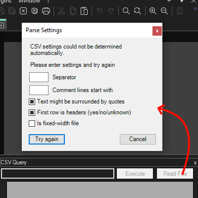

      Alan Kilborn @Bas de Reuver
      @Bas-de-Reuver
      I tried my own quick test using the N++ plugin demo, found HERE.
      I created a groupbox and an edit control on the docking dialog. I ran it and both were “dark” in dark mode (so good so far). Then in the code, I changed the parent of the edit control to be the groupbox. Rerunning that, the edit control ended up not being “dark”.
      So, not much new to add, but basically I can confirm/duplicate your results…

          Alan Kilborn @Mark Olson
          @Mark-Olson said in Darkmode doesn’t stylize all plugin controls on docked window (groupbox, panel, labels etc):
          …don’t necessarily look better
          Do you have a specific example you can show?
                @Bas-de-Reuver said in Darkmode doesn’t stylize all plugin controls on docked window (groupbox, panel, labels etc):
                … it should either be all in lightmode or all in darkmode…As far as I’m concerned it’s just a matter of consistency.
                I agree.
                Even for my simple test:
                …I changed the parent of the edit control to be the groupbox. Rerunning that, the edit control ended up not being “dark”.
                It was ridiculous to see the white edit box on the otherwise dark dialog.
