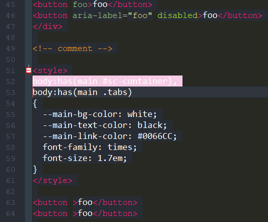

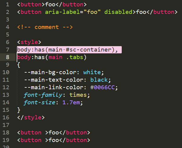

      I’m new to notepad++. I have a new work laptop and it has notepadd++ already installed and I can’t install sublime that I used to use. I was trying to get my color scheme from sublime similar but it looks like notepad++'s colors are washed out. I got the RGB value from my sublime settings but they look different in notepad++
      Here’s what sublime looks like:
      And here’s what notepadd++ looks like with the same RGB values for all the elements:
      I don’t think it’s my eyes. Notepad++ looks different.
      • The HTML tags should be a brighter pinkish color.
      • The orange comment should be brighter
      • HTML attributes should be a brighter green and the values a brighter yellow
      • My selection background color seems to be used but the selection foreground color (which I have set to black) is not used. It’s using white text.
      I verified I have the right RGB values in the Style Configurator. Am I missing something obvious?
            It’s using a different font and/or font size. That changes the shading.
            And I grabbed your two screenshot images, and found that the pink background color is exactly the same RGB triple – so if those screenshots look like a different pink to you, then it is your eyes. (Did you see a blue dress or pink dress? It’s the exact same thing here. Color context matters, and that black-foreground vs white-foreground on top of the pink background changes the way your brain interprets the color.)
            For the HTML tags, when I found a similar spot in the center of the downstroke for the b of <button>, I got the same RGB in both images.
            But your screenshots say that Notepad++ is presenting the same colors that Sublime was for those two.
            And on the green, I wonder if you happen to have “bold” on Sublime and “not-bold” on Notepad++, because they are very similar shades of green, but not identical.
