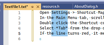

                  First, to confirm what VS does:
                  1. Column/Rectangle/Block selection:
                  2. TAB:
                  So VS does add indent at the start of the Column/Rectangle/Block.

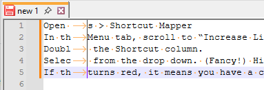

                  Now let’s look at what N++ does “out of the box” with a Column/Rectangle/Block selection in the middle of a line:
                  2. Normal, unchanged TAB:
                  This is the undesired behavior.

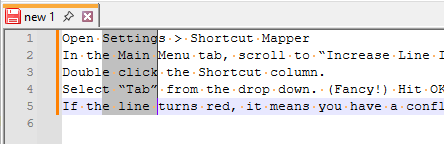

                  Now, instead, do what @Alan-Kilborn suggested in 2023:
                  1. do a zero-width column-mode selection instead of a multi-character column-mode selection:
                  2. Then hit TAB, and it will indent from that location, without deleting any characters:

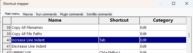

                  Now, to look at your suggestion
                  1. Change the Increase Line Indent to use the TAB key (and remove any conflicts elsewhere):
                  2. Do the Column/Rectangle/Block selection in N++:
                  3. And then hit the newly-mapped TAB:
                    … noticing that the results are the same as in step 4: it overwrites the characters.

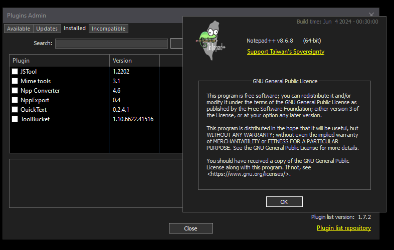

                    Should someone reading this be in a position to investigate a potential defect, here are details on my Notepad++ configuration. The plugin with the conflict for Tab was QuickText. Here is a screenshot of my Notepad++ version and installed plugins. I run Notepad++ on multiple machines, but am pretty quick to “copy paste” my plugin setup because it addresses other needs. I’ve observed this “unresponsive tab” issue on each of the other computers.
                      … And that explains the difficulty . Older versions of the QuickText plugin defaulted to TAB being the default keystroke for the Plugins > Quick Text > Replace Tags (now called Replace Snips, instead) action. As you have seen, that was a confusing default for the plugin to have, as it breaks expectations for how the main app should behave.
                      We were able to convince the current maintainer to not use such an integral key as the default keystroke – so now there is no default keystroke at all for that plugin (verified in a fresh 0.2.5.1 install); so if the user wants a shortcut, they can set their own shortcut, because no matter what was picked for the default, it was likely to conflict with the user’s current setup. (I don’t remember if 0.2.4.1 was old enough to still use TAB by default, but if you started with that, or started with an older version and upgraded at some point, the keyboard shortcut would have stayed bound to that plugin action.)
                      Given that you are on Plugin List version 1.7.2 in N++ v8.6.8, if you look on the Updates tab of Plugins Admin, you should see that QuickText should be able to be upgraded to v0.2.5.1 (the newest QuickText version was added in Plugin List 1.5.2 around N++ v8.4.5)

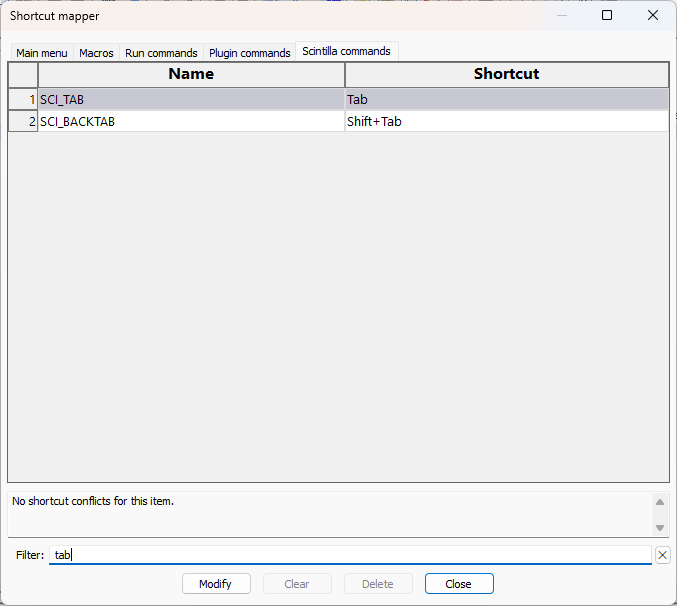

                      Regarding the mapping of the Tab key: I don’t think Increase Line Indent is the best choice for you. The normal mapping for Tab is actually the scintilla command SCI_TAB, and I highly recommend that you put it back to that default:
                      That will allow Tab to have all the magic users normally associate with that key, rather than just being able to do the Increase Line Indent that you currently have.

                        @PeterJones That fixes everything! Thank you so much! Apparently I need to be better about updating N++ plugins.
