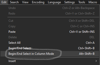

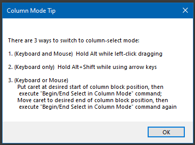

                  What you’ve described is a variant on using this command:
                  You’d use it once at the top left, then you’d move your caret to the bottom right, and execute it again.

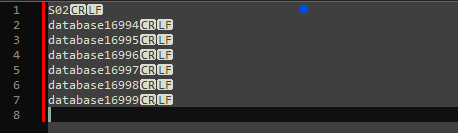

                      If you look at your original text, I presume the lines end right after the text, like this if you turn visible line-endings on:
                      Thus it is not normally possible to move the caret here (blue dot location) so that you may do the column-block paste where you want it:
                      However, as mentioned, you can get the caret there with Alt+LClick.

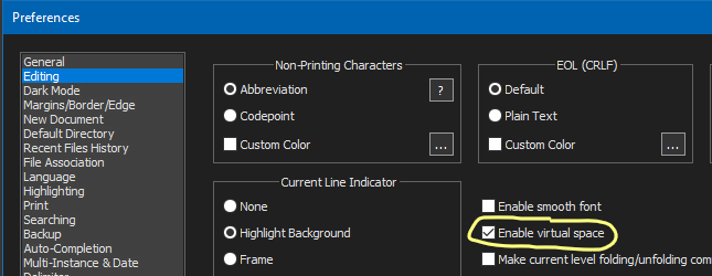

                      Another way you can get the caret there, by using the arrow keys alone, is to enable virtual space by turning this setting on:
                      With Enable virtual space on, you can freely move the caret with only the arrow keys, beyond the end-of-line characters on any line.

                        Yes, this works, but I’d say it isn’t a common usage among Notepad++ users.
                        It is so uncommon that it isn’t mentioned here (maybe it should be?):
                        Probably “Hold Alt while left-click dragging” is the way most users would select your S02 block, if they’re going to involve the mouse in the selection action.
