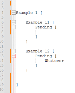

      Hello,
      I am making a User Defined Language and I was wondering how could I configurate it so everytime that it appears a certain word in a subcategory and it is not empty, the categories above should change the color.
      Here is an example
      In this case the word would be ‘Pending’, so the lines 12 and 4 should be in red.
      Thanks in advanced! :)
        PeterJones @Haichito
        @Haichito ,
        the User Defined Language syntax highlighter is not that powerful. To make complicated logic, you (or someone) would have to write a lexer plugin that implements the specific logic for your specific language.
        Or, maybe, you could use EnhanceAnyLexer plugin, which allows changing the foreground color of text based on a regex, to add highlighting on a per-language-basis, whether that language is a UDL or a builtin lexer.
        If I have understood your requirements, I believe the regex below will make it so that your Example 12 lines 12-16 will be red because the Pending section has at least one alphanumeric between the brackets, whereas the Example 11 lines 6-10 will not, because there is only whitespace between Pending’s brackets.
        [your_udl_name_here]
        0x00CC00 = (?s)\w[\w\s]+\x5B\s+Pending\h*\x5B[^\x5D]*\w.*?\x5D\s*\x5D
        HaichitoH 1 Reply Last reply Reply Quote 4
        • HaichitoH
          Haichito @PeterJones
          @PeterJones Okey, I will try to implement what you said.
          Thank you very much.
