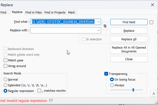

            • Sergio TobarS
              Sergio Tobar @Mark Olson
              This is how I am running it

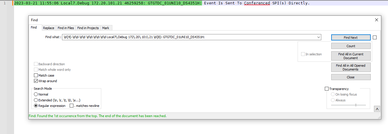

                PeterJones @Sergio Tobar
                @Sergio-Tobar ,
                Then you copy/pasted the regex wrong, or you edited it from @Mark-Olson’s version. It is not an invalid regex.
                Hovering over the ... in the speech bubble in your dialog will even tell you what went wrong in the regex you actually used, and you can then compare what it shows to Mark’s regex, to see what you copy/pasted wrong.
                Sergio TobarS 1 Reply Last reply Reply Quote 0
                • Sergio TobarS
                  Sergio Tobar @PeterJones
                  @PeterJones @Mark-Olson Perfect worked, the problem was that after the Local7.Debug, in the original file was separated by tab and not by spaces, I separated by tab the regex and it worked fine, thanks for the support.
