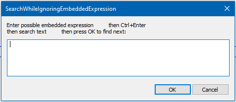

                          If we take some data:
                          &Extended area
                          E&xtended area
                          Ex&tended area
                          Ext&ended area
                          And run the script on it, we get prompted with:

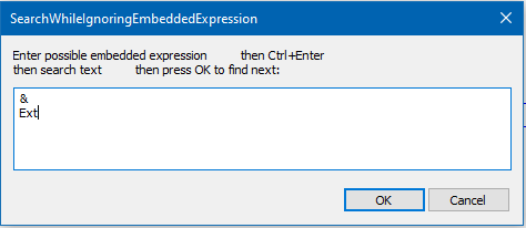

                          We enter:
                          And click OK and we are jumped to the first match:

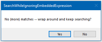

                          We are reprompted to continue the search, doing so results in a match where & is embedded inside the other data:
                          Continuing to press OK to the scripts prompting, we continue the search until we are out of matches. When this occurs, we get prompted to “wrap”:
