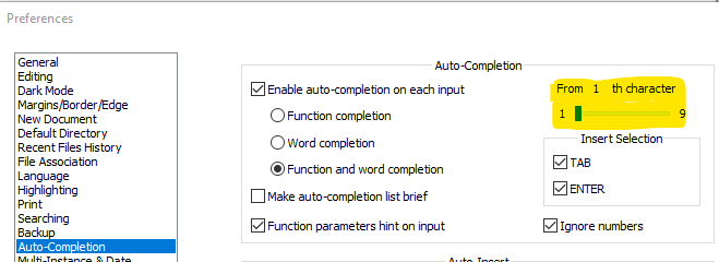

        The feature you are talking about is called Auto-completion.
        FWIW, here’s what I get with 8.5 and default settings:
        ( I’m not sure the point of the list including BA, as I’ve already got that right at the caret. )
        This is an important setting for the discussion:
        What this means is that auto-completion will not trigger until you have the indicated number of characters in your word. As the default is 1, the choice list pops up as soon as you type the B (in your BA). If you want something different, change it.
        Overall, I’m not really sure I’m getting to the root of your problem/question, so sorry if I seem off base or I’m not really answering what you’re asking.
