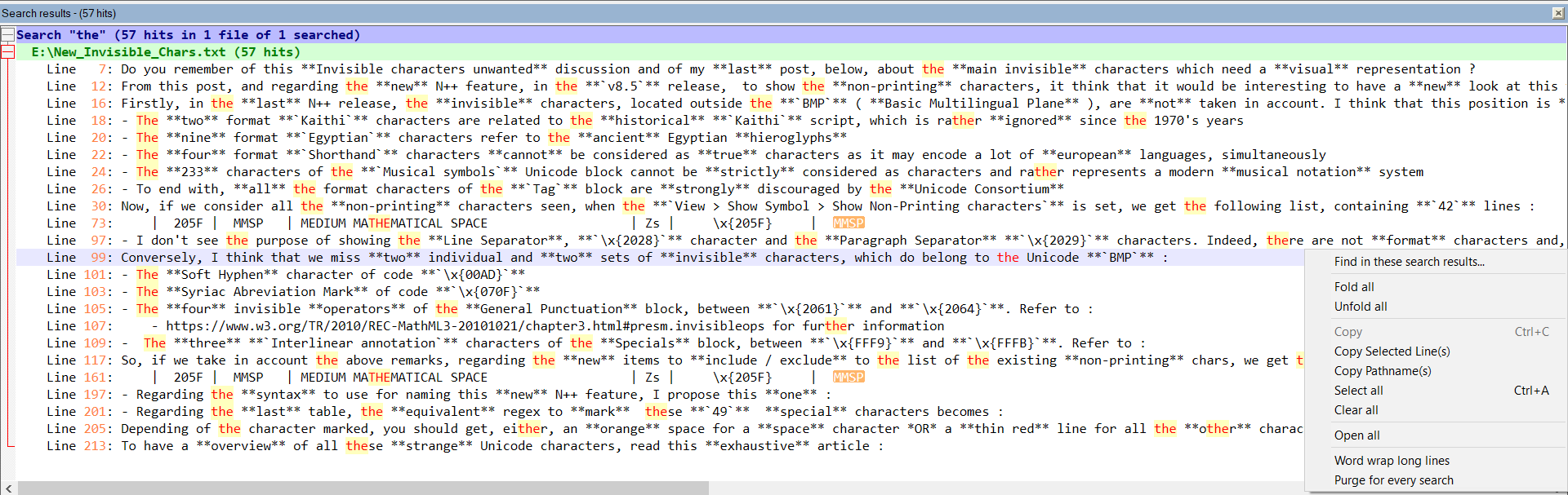

            Hello, @jeronymite2, @terry-r and All,
            I do not understand very well what is your problem !?
            Are you speaking about that feature :
            • Without word wrap :
            • With word wrap :
            My configuration :
