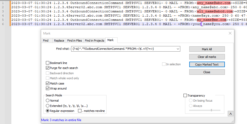

      I am trying to parse an IIS log in Notepad++ so that it returns the From address when the log line does not contain OutboundConnectionCommand.
      2023-03-07 01:30:24 1.2.3.4 OutboundConnectionCommand SMTPSVC1 SERVER01- 0 MAIL - FROM:<any_name@abc.com>+SIZE=933660 0 0 4 0 141 SMTP - - - -
      2023-03-07 01:30:24 1.2.3.4Server02.abc.com SMTPSVC1 SERVER01 1.2.3.4 0 MAIL - +FROM:<any_name@abc.com> 250 0 60 47 0 SMTP - - - -
      I want to return
      From:<any_name@abc.com>
      if OutboundConnectionCommand does not exist in the line. I assume I would have to use a negative lookbehind, but I cannot quite get the command correct.
      Tried this in regex101.com but it looks like it matches both From: strings:
      FROM:.*>(?<!\bOutboundConnectionCommand\b)

          Thanks for the RegEx. We are getting closer to what I would like. I tried your solution and it successfully selects the entire line. I apologize that I did not include the entire situation. The IIS log tells of all the emails that come into it and get sent out. So, for each email, there will be an incoming and an outgoing entry. Before, I was just extracting the email addresses, but I realized that I was double counting the email addresses (incoming and outgoing). So, I figured I would try and extract the email addresses on all lines that had OutboundConnectionCommand (the emails that are leaving IIS) and try and extract the email address between the FROM:< and the ending >. Can NotePad++, using RegEx (I assume), find the line as you noted in your reply, extract the email address between FROM:< and > ?
          I would assume that the replace line would be something along the lines of \r\n<regex of email address>\r\n so then I can apply the bookmarking of that line that would then facilitate me removing all unmarked bookmarks.
          • Zeff Wheelock 0Z
            Zeff Wheelock 0
            I have figured out how to find the line I want using:
            (?=.*\bOutboundConnectionCommand\b)(?=.*FROM)
            Now I just need to extract the email between the < and >

                  I’ve sort of lost track of what the full need is, but I think you can match the entire line with the email address into capture group 1 with:
                  Find: (?-is)^.*?OutboundConnectionCommand.*?FROM:<(.+?)>.*
                  Then you might replace with ${1} ?
                  Again, a lot of info, so I can’t really pick off what is needed.
                  Zeff Wheelock 0Z 1 Reply Last reply Reply Quote 1
                  • Zeff Wheelock 0Z
                    Zeff Wheelock 0 @Alan Kilborn
                    Unfortunately, that just blanked out the whole line. I am trying to match any line that contains the bolded content and get the email address within the Less Than/Greater Than delimiters:
                    2023-03-07 01:30:24 1.2.3.4 OutboundConnectionCommand SMTPSVC1 SERVER01- 0 MAIL - FROM:<return_email_address_between_delimiters@abc.xyz>+SIZE=933660 0 0 4 0 141 SMTP - - - -
                    Thanks for helping me out!
                      Alan Kilborn @Zeff Wheelock 0
                      @Zeff-Wheelock-0 said in RegEx - Finding strings when another substring not present:
                      Hmm, my testing shows that it replaces the line with ONLY the email address.
                      But we don’t know what this means.
                      Maybe your goal isn’t replacement in the original file…
                      If you literally mean you just want a copy of the email addresses that match the criteria you’ve previously outlined, I’d suggest a Mark operation followed by a Copy Marked Text operation followed by a paste (somewhere else).
                      Find: (?-is)^.*?OutboundConnectionCommand.*?FROM:<\K.+?(?=>)
                      Press Mark All.
                      Press Copy Marked Text.
                      Move to new tab; paste:
                      Zeff Wheelock 0Z Mark OlsonM 2 Replies Last reply Reply Quote 4

                        Thanks! I had the previous version of Notepad++. Upgraded to the new version and your solution worked flawlessly and fast! Thanks for the help!
