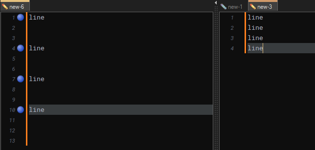

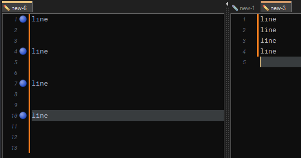

                As mentioned earlier, this script assumes that the number of bookmarked lines is identical to the number of lines edited in the other view.
                For example, int this case when using copy bookmarked lines
                you need to get rid of the 5 line in the second view.
