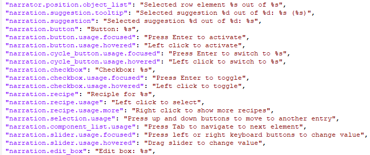

    Need to find lines that are missing a comma at the end.

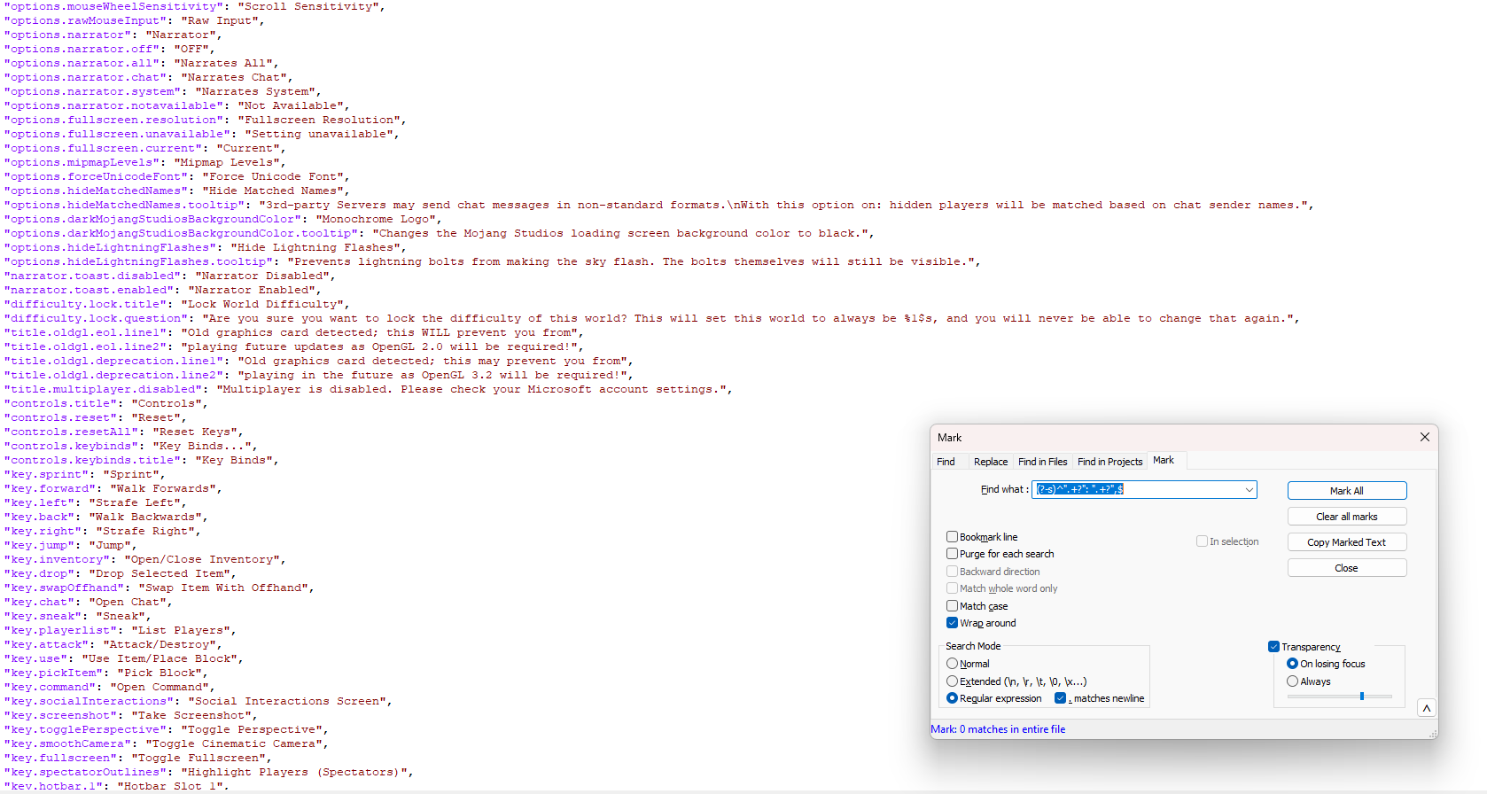

            I used the Mark operation and did not find any matching results (There is a nonzero chance I did it wrong)
            I would like to provide more information about how the data is being utilized but struggle to describe how it is as I am not very experienced in this field. For what it’s worth, the information is being accessed by Minecraft and applied to specific text labels spread out through different areas of the game. Here’s another screenshot with more data that is (hopefully) more useful. Any ideas? Thank you for your help up to this point, by the way.
              PeterJones @Monarchia
              @Monarchia ,
              Your file format looks rather JSON-like. If the simple checks that @Alan-Kilborn has pointed out are not finding anything, you might try installing the JSONTools plugin which (IIRC) can do a syntax check on JSON, and might take you to the line where it’s wrong. If that doesn’t find it, then it’s probably not a syntax error, and it’s instead a data-error: ie, some valid JSON string is something that the minecraft engine cannot handle, hence your problem – but if that’s the case, we won’t be able to help you, because this is not a minecraft-modding forum.

                      Hello, @monarchia, @alan-kilborn, @peterjones and all,
                      Well, @monarchia, after using the Irfanview sofware with a recognition characters plugin and some minor ajustments, I was able to extract this text from your first image which can be transformed into this functional json block, below :
                       "narrator.position.object list": "Selected row element %s out of %s",
                       "narration.suggestion.tooltip": "Selected suggestion %d out of %d: %s (%s)",
                       "narration.suggestion": "Selected suggestion %d out of %d: %s",
                       "narration.button": "Button: %s",
                       "narration.button.usage.focused": "Press Enter to activate",
                       "narration.button.usage.hovered": "Left click to activate",
                       "narration.cycle button.usage.focused": "Press Enter to si~tc:~ to %s",
                       "narration.cycle~button.usage.hovered": "Left click to switc:~ to %s",
                       "narration.checkbox": "Checkbox: %s",
                       "narration.checkbox.usage.focused": "Press Enter to toggle",
                       "narration.checkbox.usage.hovered": "Left click to toggle",
                       "narration.recipe": "Reciple for %s",
                       "narration.recipe.usage": "Left click to select",
                       "narration.recipe.usage.miore": "Right click to show miore reclpes",
                       "narration.selection.usage": "Press up and down buttons to nove to another entry",
                       "narration.comqoonent~list.usage": "Press Tab to navigate to next element",
                       "narration.slider.usage.focused": "Press left or right keyboard buttons to change value",
                       "narration.slider.usage.hovered": "Drag slider to change value",
                       "narration.edit~box": "Edit box: %s"
                      Now, @monarchia, try the following method to get all specific lines which do not have the right format :
                      • Untick all box options
                      • SEARCH (?x-s) ^ \h* " .+? " : \x20 " .+ ? " , $ (*SKIP) (*F) | ^ .+
                      • Check the 2 options Bookmark line, and Purge for each search
                      • Move to the very beginning of your json file
                      • Now, hit the F2 key, repeatedly, to get the different lines which do not satisfy your format !
                      Remark the part \h*, at beginning of the regex, which could explain why the previous @alan-kilborn’s solution found nothing !
                      Running this regex against the json block above, previously copied in a new tab, should obviously mark the lines { and }, as well as the last data line "narration.edit~box": "Edit box: %s" which does not end with a comma character !
