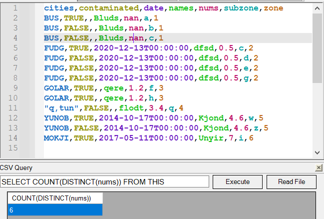

                  Have you tried the CSVLint or CSVQuery plugins?
                  Those are good solutions for problems like this, although CSVQuery requires you to write a SQL query.
                  The pretty colors are from CSVLint, and the table view with SQL is from CSVQuery.
                  Honestly I would just use pandas, but you wanted a solution inside Notepad++ so…
