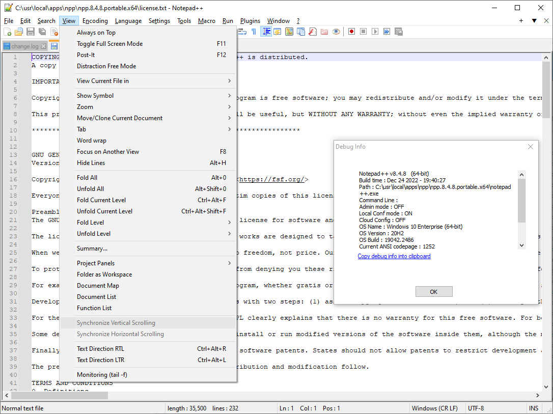

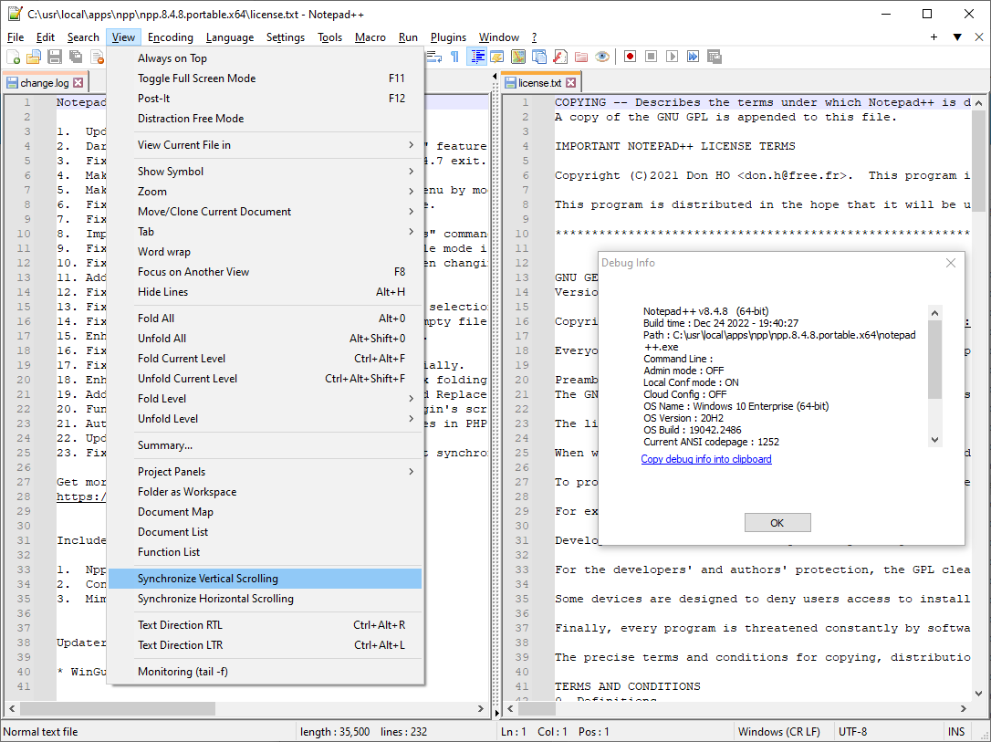

                img desc
                d401c630-fb62-4f0d-b2bf-c4e5b0642b3b-image.png two files one view, no sync available
                7adfde11-b95c-4953-85ab-a6ca109e0b8b-image.png two files two views, sync is available
                So, it’s obviously not that Notepad++ v8.4.8 can never synchronize the two views.
                I used the synchronize-vertical and horizontal scrolling functions before, and after version updating the function is always inactive.
                That still sounds like the situation that @Alan-Kilborn described, with it only happening when Notepad++ restarts (because Notepad++ restarts after an update) and then doesn’t remember to keep them synchronized. You should be able to convince it to synchronize again by moving everything to the main (left/top) view, then move one or more files back to the second view.
                Yes, I just tried: after the screenshot condition above, I told it to sync both vertical and horizontal (which worked). Then I exited Notepad++ and re-started Notepad++: it remembered the two files were open in two different views, but had the View > Synchronize Vertical/Horizontal Scrolling disabled (this confirms the bug report that Alan linked to earlier). When I moved the right file to the left (so it was back to one view), then moved it back to the right (so it was back to two views), the View actions were re-enabled.
