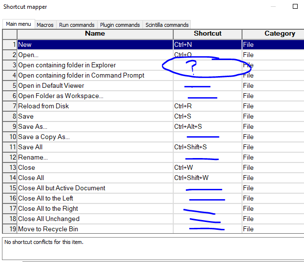

      submitific
      How do you add keyboard shortcuts to Notepad++??

        • submitificS Offline
          submitific @Terry R
          @Terry-R Thanks Terry, I did that, but only found how to change ones that existed already, which is why I posted here.
          It would have been easier if you just posted the link and kept the abuse in your head.

                    • Michael NeumannM Offline
                      Michael Neumann
                      Hi,
                      it is totally legit to ask how to ADD Keyboard Shortcuts.
                      In Settings/Shortcut Mapper You only can:
                      • change an existing Keyboard Shortcut to something else (or “NONE” to remove)
                      • remove an assigned Keyboard Shortcut
                      • assign a Keyboard Shortcut to a function which currently has no Shortcut
                      There are effectively only 2 Buttons / context menu entries available:
                      • Modify
                      • Remove
                      Unfortunately You CANNOT ADD an ADDITIONAL Keyboard Shortcut there.
                      I came here, because I am searching for a solution for my problem:
                      I want to change the Shortcut Setting of “IDM_FILE_CLOSE”, which is normally only bound to <Ctrl>-<W>.
                      I want to use <Ctrl>-<F4> and <Ctrl>-<X> as ADDITIONAL Keyboard Shortcuts for “IDM_FILE_CLOSE”, Shortcut id=“40003”.
                      I’m also a “nano” user, where I use <Ctrl>-<S> / <Ctrl>-<X> to save and exit, I recognized I’m trying to use this key combination in npp too…
                      So I removed the key binding <Ctrl>-<X> (SECONDARY Key Shortcut of Edit/Cut), as I am using <Shift>-<DEL> for that.
                      And I did some testing:
                      There are 2 default Shortcuts / 2 entries in Settings/Shortcut Mapper for exactly the same function: Edit/Cut: (for Copy&Paste too)
                      1. <Shift>-<DEL>
                      2. <Ctrl>-<X>
                      menuCmdID.h shows
                      IDM_EDIT_CUT = 42001.
                      When Changing these two shortcuts
                                  to               --> this will will result in
                      Cut (1) --> Strg-Alt-Shift-1 --> <Shortcut id="42001" Ctrl="yes" Alt="yes" Shift="yes" Key="49"/>
                      Cut (2) --> Strg-Alt-Shift-2 --> <Shortcut id="42001" Ctrl="yes" Alt="yes" Shift="yes" Key="50" nth="1"/>
                      in shortcuts.xml.
                      When Changing File/Close to
                      Strg-Alt-Shift-3
                      this will result in
                              <Shortcut id="41003" Ctrl="yes" Alt="yes" Shift="yes" Key="51"/>
                      but adding a similar “shortcuts.xml” entry with nth=“1”:
                              <Shortcut id="41003" Ctrl="yes" Alt="yes" Shift="yes" Key="52" nth="1"/>
                      for using
                      Strg-Alt-Shift-3
                      as SECONDARY shortcut for “IDM_FILE_CLOSE” doesn’t work, it’s completely ignored.
                      After Changing any other setting via Shortcut Mapper, the handmade entry
                      is automatically removed from shortcuts.xml…
                      So it looks that Edit: Copy/Cut/Paste only can have 2 keyboard shortcuts at the same time, because this is programmatically provided,
                      and it’s not possible for the user to add additional shortcuts via shortcuts.xml…
                      The Shortcut Mapper should:
                      • offer an button or context menu entry to reset the currently selected function to it’s default shortcut
                      • offer an button or context menu entry to add/create an additional shortcut for the currently selected function
                      • should display the “Shortcut id” of the currently selected entry, so that an experienced user can easily add/modify an entry to/in shortcuts.xml by himself.
                      Thank You and Best Regards,
                      Michael
