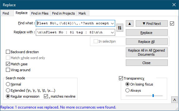

            The regex:
            Fleet No\,(\d{4})\,.*?auth accepted tag=(\d{16})
            with the “Regular expression” radio button and “. matches newline” checked will find your data.
            Using the replace dialogue on a copy of your file (this operation would be destructive), you could use:
            \n\nFleet No : $1 tag : $2\n\n
            Zorba GreekZ 1 Reply Last reply Reply Quote 2

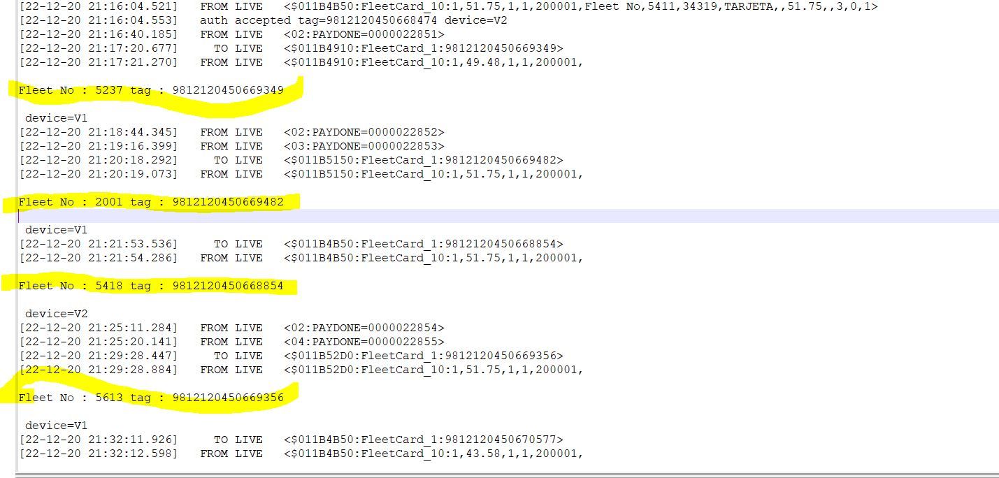

              Zorba Greek @Michael Vincent
              @Michael-Vincent said in Extract specific data from log files?:
              just there, i want to delete everything except the selected file
                Michael Vincent @Zorba Greek
                @Zorba-Greek said in Extract specific data from log files?:
                An expert more versed than I may be able to help with a single stroke - for me, without a scripting solution, this is a multi-step process.

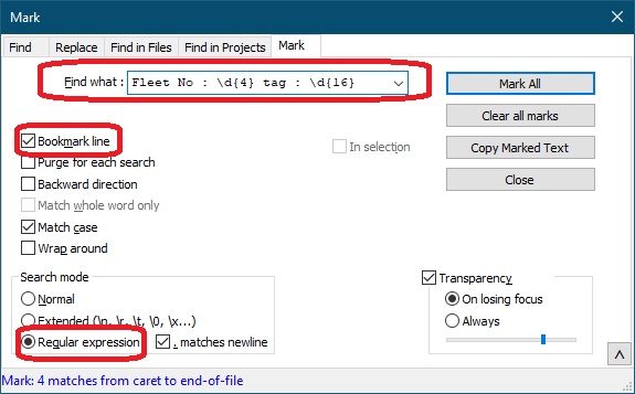

                Now that you have the lines you want, use the Search => Mark menu item to bookmark the lines:
                Find what:
                Fleet No : \d{4} : \d{16}
                Check the “Bookmark line” checkbox:
                The right-click the bookmark margin and select “Copy Bookmarked Lines”, open a new tab and paste.
                Terry RT Zorba GreekZ 2 Replies Last reply Reply Quote 3
