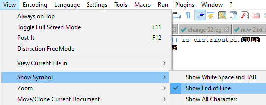

            First, turn on visible line endings so that you have confidence the editor is doing what you want:
            As you can see in my screenshot, when I do this Notepad++ is showing me what I have for line endings (note the inverse video CRLF) in the background.

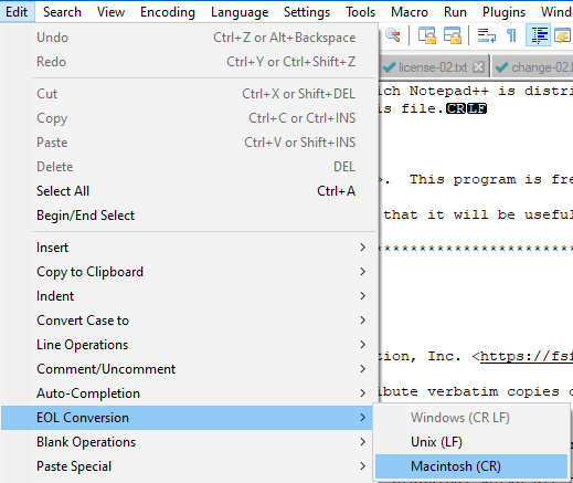

            Next, you want to make the “Macintosh” selection, like this:

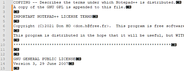

            Then, you’ll see what you want/need in your text; example using my file:
            Each line ends with a CR now.

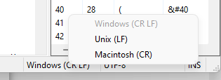

              So this means you are creating a new file from scratch, and thus it defaulted to Windows CRLF endings. Use the method Alan showed (or right clicking on the “Windows (CRLF)” on the lower-right of the Notepad++ status bar) to change the line endings.
