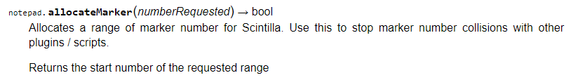

                  there should be a “cough up a free marker ID, and then don’t give that same marker ID to anyone else that asks for a free one” plugin message/function.
                  Oh wait, it appears there IS the plugin message I’m talking about. Doh!
                  See HERE in N++ code.
                  And then this in the PS docs:
                  I suppose I haven’t noticed this because in all of my scripting endeavors, I haven’t needed to use a custom marker (or, I just don’t remember – failing memory disclaimer!).
                  Paul WormerP 1 Reply Last reply Reply Quote 2

                          @Alan-Kilborn I expected a boolean upon return: if true markerNr is allocated; if false markerNr is free. That is not how it works apparently.
                            Alan Kilborn @Paul Wormer
                            @Paul-Wormer said in Marker number:
                            No, it isn’t, but…why do you care what the actual number is?
                            In your code, go with:
                            my_marker_id = notepad.allocateMarker(1)
                            and then wherever you were using a hard-coded-magic-number for a marker number, use my_marker_id instead:

                              @Alan-Kilborn Yes, of course. It seems that the description of notepad.allocateMarker is wrong by stating --> bool. Instead it should state --> int. That put me off.
                                Good catch!
                                See HERE.
