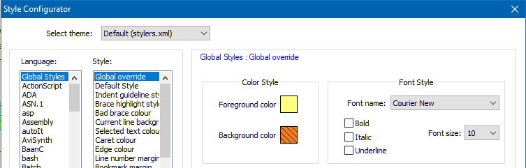

            Alan Kilborn @Ian Turner
            @Ian-Turner said in New setting to adjust font sizes ?:
            it is certainly a less than obvious place to find font size,
            Well, if you didn’t find it in the Preferences (and you didn’t because it isn’t there), where else is the most likely place to look from the choices you have?:
            And from there, there’s a lot of “font” that appears on the opening page:
            So you then know you’re in the right place.

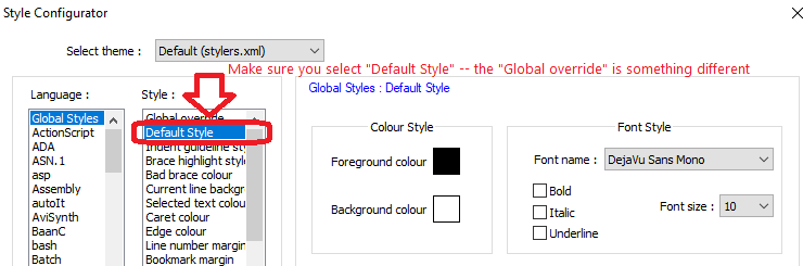

                PeterJones @Ian Turner
                @Ian-Turner
                Just to clarify: Alan’s post shows the style configurator with “Global override” selected. At that point, you need to select the next entry down to choose the “Default style” that I mentioned earlier. “Global override” and “Default style” do two different things, and “Default Style” is the one you want in this case.

                  @Peter Jones : Thanks again, I did actually discover that when I changed the top one :-))
