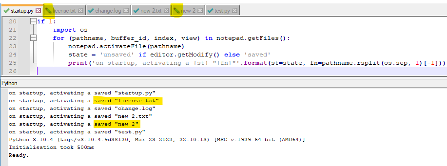

I’m having trouble detecting the saved/unsaved state of the filetabs at Notepad++ 8.4.7 startup using a script. Specifically, I’m being told that I have no unsaved tabs, when I do have some:
Here’s the code as text:
if 1: import os for (pathname, buffer_id, index, view) in notepad.getFiles(): notepad.activateFile(pathname) state = 'unsaved' if editor.getModify() else 'saved' print('on startup, activating a {st} "{fn}"'.format(st=state, fn=pathname.rsplit(os.sep, 1)[-1]))Can anyone that’s inclined to, try and duplicate this?
Also, if there are any ideas for successful retrieval of the saved/unsaved state of the tabs at startup, I’d like to hear them. I have some “wild” ideas, but I lack simple solutions (the kind I like).

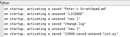

It gives the values I expect: new1 was unsaved but no changes (no content yet), LICENSE was changed and unsaved, new2 was unsaved with changes. And the script output agreed.
Actually, I ran that from the console instead of a script. Run it again from a saved script:
Still works for me.
Maybe it’s a timing issue for you. Try putting a quarter or half-second sleep between the
activateFileand thegetModify– I know that some of my scripts, I have to give Notepad++ enough time to switch active files and potentially re-lex the document (especially if it’s big) -

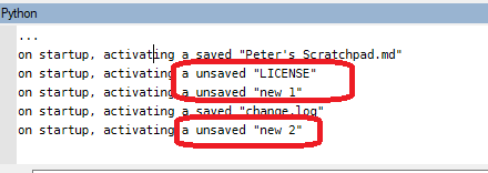

When I did enable periodic-backup and made sure that I had toggled through all the files so it made the 7sec backup for the edited ones, then restarted Notepad++, you are right: it didn’t bring back
new 1, and all the files claimed to be saved, even though they are properly shown as edited/unsaved in the tabbar list.on startup, activating a saved "Peter's Scratchpad.md" on startup, activating a saved "LICENSE" on startup, activating a saved "change.log" on startup, activating a saved "new 2" on startup, activating a saved "23908-saved-unsaved-list.py" on startup, activating a saved "startup.py"
So at startup, the answer is wrong. And if I rerun the script manually without making new changes, it still shows them as all being saved.
So yes, I concur that getModify() apparently returns whether it’s been changed since the load, rather than whether it’s been changed from the “saved” state.
