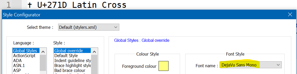

                  In both apps, the default font is set to Consolas.
                  Try DéjaVu Sans Mono:
                  Don’t forget to also turn off DirectWrite.
                  • rdipardoR
                    rdipardo @rdipardo
                    @me,
                    On a second look, it seems DirectWrite has no effect on DejaVu Sans Mono (maybe because it’s open source?). By contrast, every Microsoft font displays the “emoji” style with D2D switched on. It’s most likely a quirk in Scintilla (the editing component).
