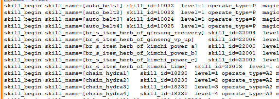

      Hello.
      I’m looking for help with text sorting. I have a large datapack (60k+ rows) that is not sorted by ID.
      I tried using the standard sorting functions by numeric value, but since in the skill_name=[…] section there are also different letters and numbers - this breaks sorting.
      Is there any way to sort rows by numeric value inside skill_id=[…]? or is it impossible in NPP++ and I need to write a parser for sorting it?
      Thanks in advance for your replies.
