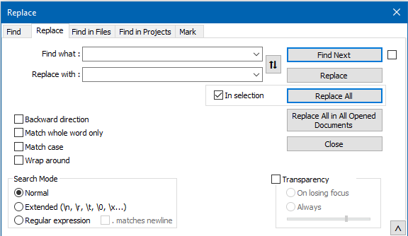

        • set up the Replace window to look like this:
          (the important parts are a single space character in Find what, absolutely nothing in Replace with, and In selection checked)

        When you run the Macro (it will appear on the Macro menu after you save it), it will de-spacify your selected lines, in-place, and copy them to the clipboard. You just have to manually press Ctrl+z (undo) now to get the original lines back in place. But, your goal of having the de-spacified lines in the clipboard is achieved, with less fuss than you had – probably it goes without saying that you can assign the running of a saved macro to a keycombination of your choice.
