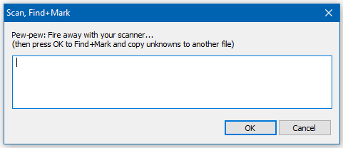

          Alan Kilborn @Tecknat Trippare - VHS Insamling
          @Tecknat-Trippare-VHS-Insamling
          With scripting, you can make Notepad++ do basically anything you want; example of a UI you could create:
          Tecknat Trippare - VHS InsamlingT 1 Reply Last reply Reply Quote 3
              @Tecknat-Trippare-VHS-Insamling said in Mark with same function jumping to row as Find?:
              Is it possible to Find+Mark with a script also?
              Scripts can do amazing things.
              This sounds like an easy thing.
              So, I’d say Yes (just like it seems I said before).
