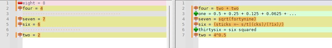

But this did not work as desired.Can you show an example of that “not working as desired”?
It may be that there’s an option on the Compare Plus plugin you can change (or maybe a feature that exists in Compare Plus that didn’t exist in the original Compare plugin – I know the Compare Plus is better at aligning things than the original Compare was)
file1:
six = 6 four = 4 two = 2 seven = 7 eight = 8file2:
one = 0.5 + 0.25 + 0.125 + 0.0625 + ... two = 4^0.5 four = two + two six = (sticks =~ s/t|(cks)/(?1x)/) seven = sqrt(fortynine) thirtysix = six squaredsorted and compared:
That highlights the exact differences as I would expect. (And that’s with the old Compare plugin) (Okay, technically, I sorted then “removed blank lines” in both files) -

Did I miss something?I had hoped that my image headers saying “sorted”, and then my later paragraph saying “I sorted then ‘‘removed blank lines’’ in both files” would have communicated that. But to be more explicit:
The steps I took in my screenshots on Saturday were:
- Put file1 in view 1 and file2 in view 2; have File 1 active
- Edit > Line Operations > Sort Lexicographically Ascending
- Edit > Line Operations > Remove Empty Lines
- Use F8 (View > Focus on Another View) to make file2 active
- Plugins > Compare (or Compare Plus) > Compare
The “four menu options” I meant were steps 2,3, 5,6.

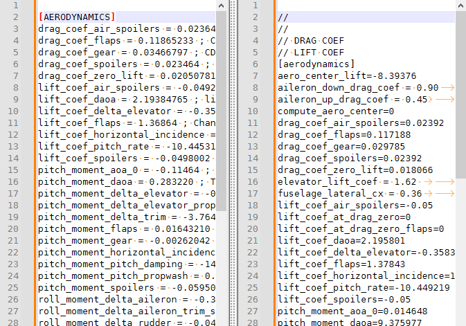

Her are the 2 exampels from the files I want the lines in"model1" to be orderd after document “model2”
[AERODYNAMICS] drag_coef_zero_lift = 0.0205078124 ; The zero lift drag polar drag_coef_flaps = 0.11865233 ; Cd_df Drag Coefficient - Flaps drag_coef_gear = 0.03466797 ; CDg (Drag Coefficient - Landing Gear) drag_coef_spoilers = 0.023464 ; 0.023464 Cd_ds Drag Coefficient - Spoiler drag_coef_air_spoilers = 0.0236436 lift_coef_daoa = 2.19384765 ; lift per change in angle of attack rate lift_coef_pitch_rate = -10.4453125 ; The change in lift per change in pitch rate lift_coef_delta_elevator = -0.3583984 ; The change in lift per change in elevator deflection lift_coef_horizontal_incidence = 1.89208984 ; The change in lift per change in horizontal incidence angle lift_coef_flaps = 1.36864 ; Change in lift due to flaps lift_coef_spoilers = -0.0498002 ; Change in lift due to spoilers lift_coef_air_spoilers = -0.049264 roll_moment_slip_angle = -0.081964295 ; The change in roll moment per sideslip angle(DIHEDRAL EFFECT) roll_moment_delta_aileron = -0.39990233 ; (control)The change in roll moment per change in aileron deflection roll_moment_delta_rudder = -0.04345704 ; (control)The change in roll moment per change rudder deflection roll_moment_roll_damping = -3.96386717 ; Cl_p Roll Moment - Roll Rate (Damping) roll_moment_yaw_rate = -0.1015623 ; Cl_r Roll Moment - Yaw Rate roll_moment_spoilers = 0.05522 ; The change in roll moment due to spoilers roll_moment_delta_aileron_trim_scalar = -0.00523 ; Change in roll moment due to aileron trim pitch_moment_aoa_0 = -0.11464 ; Pitch moment at zero angle - of - attack pitch_moment_daoa = 0.283220 ; The change in pitch moment per change in angle of attack pitch_moment_delta_elevator = -0.7875936 ; The change in pitch moment per change in elevator deflection pitch_moment_horizontal_incidence = 4.421377 ; The change in pitch moment per change in horizontal incidence angle pitch_moment_pitch_damping = -1464.564 ; The change in pitch moment per change in pitch rate(PRIMARY PITCH STABILITY FACTOR). deg/s pitch_moment_delta_elevator_propwash = -3.64012 ; Cm_dT Pitch Moment - Thrust pitch_moment_pitch_propwash = 0.0 ; Cmq_dT Pitch Damping - Thrust pitch_moment_delta_trim = -3.764022 ; The change in pitch moment per change in trim pitch_moment_flaps = 0.01643210 ; The pitch moment due to flaps pitch_moment_gear = -0.00262042 ; The pitch moment due to gear pitch_moment_spoilers = -0.0595002 ; The pitch moment due to spoilers yaw_moment_slip_angle = 0.288571 ; The change in yaw moment per change sideslip angle(WEATHER VANING EFFECT) yaw_moment_delta_aileron = -0.007324217 ; (adverse yaw) The change in yaw moment per change aileron deflection yaw_moment_delta_rudder = 0.04886719 ; (control)The change in yaw moment per change in rudder deflection PRIMARY YAW POWER FACTOR yaw_moment_delta_rudder_propwash = 0.0 ; (control) yaw_moment_yaw_propwash = 0.0 ; (damping) yaw_moment_roll = 0.0678712 ; (adverse yaw) The change in yaw moment per change in roll rate deg/s yaw_moment_yaw_damping = -0.896484374 ; (damping)The change in yaw moment per change in yaw rate(PRIMARY YAW STABILITY FACTOR deg/s) yaw_moment_delta_rudder_trim_scalar = 1.123621 ; Change in yaw moment due to rudder trim side_force_slip_angle = -0.1330859377 ; (yaw angle) The change in side force per change in side slip angle side_force_delta_rudder = 0.33150390614 ; The change in side force per change in rudder deflection side_force_roll_rate = 0.089062362 ; (roll velocity) The change in side force per change in roll rate side_force_yaw_rate = 0.099541314 ; (yaw velocity) The change in side force per change in yaw rate[aerodynamics] // elevator_lift_coef = 1.62 // EXP WAS 1.80 rudder_lift_coef = 1.725 // EXP WAS 1.25 aileron_up_drag_coef = 0.45 // EXP WAS 0.5 aileron_down_drag_coef = 0.90 // EXP WAS 1.0 fuselage_lateral_cx = 0.36 // EXP compute_aero_center=0 aero_center_lift=-8.39376 presspt_fwd_Alpha0_pMAC=0 presspt_fwd_AlphaStall_pMAC=0 presspt_fwd_AlphaHiStall_pMAC=-0.25 // LIFT COEF lift_coef_at_drag_zero_flaps=0 lift_coef_at_drag_zero=0 lift_coef_delta_elevator=-0.358398 lift_coef_horizontal_incidence=1.891602 lift_coef_flaps=1.37843 lift_coef_spoilers=-0.05 lift_coef_air_spoilers=-0.05 // DRAG COEF drag_coef_zero_lift=0.018066 drag_coef_flaps=0.117188 drag_coef_gear=0.029785 drag_coef_spoilers=0.02392 drag_coef_air_spoilers=0.02392 // side_force_delta_rudder=-0.1743 side_force_roll_rate=0.014648 side_force_yaw_rate=0 side_force_slip_angle=-1.24512 // -0.124512 pitch_moment_delta_elevator=-1.391602 pitch_moment_delta_trim=-3.525 pitch_moment_pitch_damping=-178.222656 pitch_moment_aoa_0=0.014648 pitch_moment_daoa=9.375977 pitch_moment_horizontal_incidence=4.421875 pitch_moment_flaps=0.0155 pitch_moment_gear=-0.0025 pitch_moment_spoilers=0.005 pitch_moment_delta_elevator_propwash=0 pitch_moment_pitch_propwash=0 lift_coef_pitch_rate=-10.449219 lift_coef_daoa=2.195801 roll_moment_delta_aileron=-0.401855 roll_moment_roll_damping=-2.127441 roll_moment_yaw_rate=-0.019531 roll_moment_delta_rudder=-0.043945 roll_moment_slip_angle=0.072266 roll_moment_spoilers=0.055 roll_moment_delta_aileron_trim_scalar=-0.039247 yaw_moment_delta_rudder_trim_scalar=0.017896 yaw_moment_roll=0.036621 yaw_moment_slip_angle=0.172852 yaw_moment_delta_rudder=0.230469 yaw_moment_delta_aileron=-0.009766 yaw_moment_yaw_damping=-1.171875 yaw_moment_delta_rudder_propwash=0 yaw_moment_yaw_propwash=0They are totaly diferent but at the same time the same type of parameters.
I changed the parameters, copied wrong. It is only a few lines of about 400 lines.

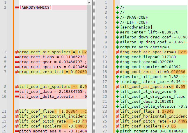

It is considered rude to edit a post after you have received a reply. Because your data now does match, it makes it look like I was wrong when I said your data doesn’t match; but two hours ago, it didn’t match. Now it does.
If I take the first half of your edited post, and sort it as file1 on the left, and the second half of your edited post, and sort it as file2 on the right, then run ComparePlus > Compare, it properly lines things up. The same would have happened if you used my macro.
sorted:
compared:
