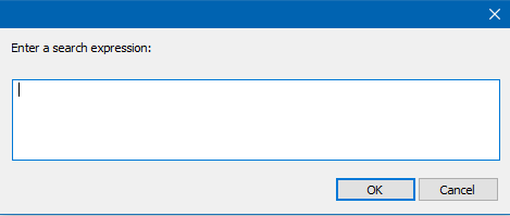

                  The PythonScript plugin can do searches where the find text is longer than the N++ UI limit of 2046 characters. I tried something like 37000 characters and it had no trouble with that.
                  But interfacing to it is not “simple”. The typical way would be through PythonScript’s “prompt” box, example:
                  The problem with that is that the maximum number of characters enterable there is 999. :-(
                  So, while PythonScript can find long expressions, interfacing to doing so is a bit difficult.
