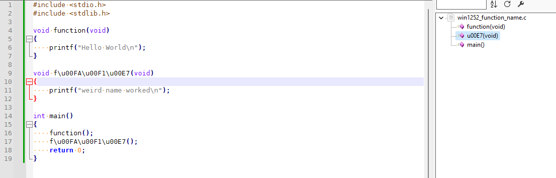

            PS: the c.xml parser is not actually good enough. Because according to that same page, using what they called the “universal character syntax”, and the gcc FAQ calls the “UCN”, using \u#### or \U######## inside function identifiers is legal and supported by the gcc compiler:
            #include <stdio.h>
            #include <stdlib.h>
            void function(void)
                printf("Hello World\n");
            void f\u00FA\u00F1\u00E7(void)
                printf("weird name worked\n");
            int main()
                function();
                f\u00FA\u00F1\u00E7();
                return 0;
            And I was able to run it with
            c:> gcc -std=c99 -fextended-identifiers win1252_function_name.c -o win1252_function_name & win1252_function_name
            Hello World
            weird name worked
            … but Notepad++'s parser doens’t recognize the whole name, because it doesn’t allow \ in the function name.
