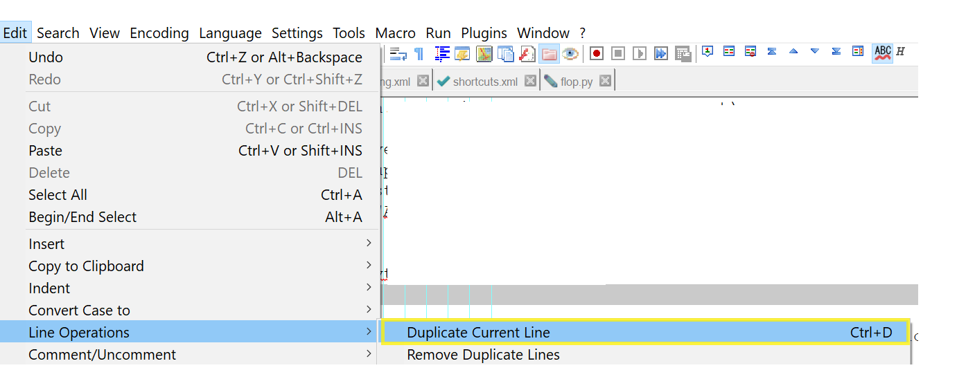

CTRL+D gives selection not line
My Shortcut mapper defines CTRL+D as SCI_SELECTIONDUPLICATE and not as SCI_LINEDUPLICATE, whereas the edit menu defines CTRL+D as “Duplicate Current Line” (see the screen shot). I find this somewhat confusing, because CTRL+D indeed duplicates a selection and not necessarily the current line.

@Alan-Kilborn Thank you. Two questions:
- How do you remember all this?
- The problem that you signaled as long ago as February 2019 has not been solved yet, do you know why?
For the time being I assigned sci_lineduplicate to ctrl+d, because the action agrees more with what I was used to.

@Neil-Schipper I did not know that sci_selectionduplicate had the double functionality that you describe. Now that I know it, I set ctrl+d back to it. I agree with you that the description in the popup menu should mention both functions.
@Paul-Wormer said in CTRL+D gives selection not line:
Many commands have slightly different functionality if a selection is active (or not) when invoked. Somewhat obviously, the command functionality involves the selection if one is active, typically limiting the command to operating on only the selection.
the description in the … menu should mention both functions
It might be cumbersome visually to see both types of functionality expressed in menu text.
