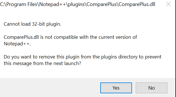

      we are just now looking at deploying v.8.4.7 company-wide and are struggling with plugin deployment. our current deployment script is bellow
      @echo off
      taskkill /F /IM notepad++.exe
      rm "C:\Program Files\Notepad++\*.VERSION"
      ::start the main notepad++ installer
      START /Wait "" "%CD%\npp.8.4.7.Installer.x64.exe" /S
      ::echo the version file to the np++ default install location
      ECHO.> "C:\Program Files\Notepad++\8.4.7.VERSION"
      ::Check for existing install of compareplus and remove if already installed
      if exist "C:\Program Files\Notepad++\Plugins\ComparePlus\" rmdir "C:\Program Files\Notepad++\Plugins\ComparePlus" /s /q
      ::install latest version of compareplus
      mkdir "C:\Program Files\Notepad++\Plugins\ComparePlus"
      robocopy "ComparePlus_cp_1.1.0_x64" "C:\Program Files\Notepad++\Plugins\ComparePlus" /COPYALL /E
      ::Check for existing install of XMLtools and remove if already installed
      if exist "C:\Program Files\Notepad++\Plugins\XMLTools\" rmdir "C:\Program Files\Notepad++\Plugins\XMLTools" /s /q
      ::install latest version of XMLtools
      mkdir "C:\Program Files\Notepad++\Plugins\XMLTools"
      robocopy "XMLTools-3.1.1.13-x64" "C:\Program Files\Notepad++\Plugins\XMLTools" /COPYALL /E
      this installs perfectly well however when the user next launches notepad++ they receive an error that the installed plugins cannot be loaded as they are 32 bit.
      does anyone have any suggestions as to where to begin troubleshooting this?
      Regards
      Daryl
      EDIT: issue was resolved by modifying the robocopy calls in the above script to remove the /COPYALL switch which was incorrectly added and caused issues when deploying via intune. amended script bellow

        Alan Kilborn @Daryl Titcomb
        @Daryl-Titcomb
        Get the 64-bit version of the plugin.
        Period.
        Daryl TitcombD 1 Reply Last reply Reply Quote 0
        • Daryl TitcombD Offline
          Daryl Titcomb @Alan Kilborn
          @Alan-Kilborn thank you for your assistance, these are the 64 bit versions of the plugins, that is why I created the post. they run fine on test instances when copied in manually, you can even see the paths they are copied from include x64 in the path.

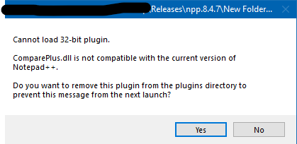

            @Daryl-Titcomb
            Ah.
            Ok, so I tried creating a zero-length (intentionally “corrupt” dll) file:
            ...\plugins\ComparePlus\ComparePlus.dll
            And I got the same error message you received:
            This is somewhat surprising (the error message being “… 32-bit …”), leading one down the wrong path…
            So, my new advice might be to look at possible corruption in the copied files.
            Daryl TitcombD 1 Reply Last reply Reply Quote 1
              @Alan-Kilborn the SHA-256 hashes of the files match which to me would indicate the issue isn’t with corrupt DLLs however it is good to know that corrupt DLLs could cause the issue.
                @Daryl-Titcomb
                I think quite possibly the “…32-bit…” error message might occur for ANY failure in loading the plugin DLL. So, even if the files are not corrupt, I suppose there could be permissions issues or other problems relating to the file system…?
                EDIT: Ok, I’d be wrong in that. :-) HERE’s the code that loads a plugin. And HERE’s where it sets your error message.
                Daryl TitcombD 2 Replies Last reply Reply Quote 4
                  @Alan-Kilborn thank you, you seem to have hit the nail on the head, the subfolders created by the script are not correctly inheriting permissions from “C:\Program Files” and therefore <devicename>\Users didn’t have permission to execute the DLL, just modifying the script now to force inheritance on those folders and will update shortly once I have pushed a test deploy
