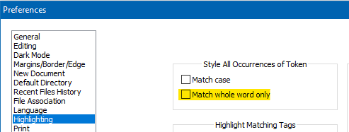

      I was trying to find in the manual the definition of “Token”, such as the term appears in “Search > Style All Occurrences of Token”. Unfortunately, I haven’t been able to find it, although I did find “the word at the caret”. I suspect that this is the meaning of “Token”? Does it mean that there is no way to style arbitrary strings?

            Alan Kilborn @Paul Wormer
            @Paul-Wormer said in Manual: chapter Search:
            A token is a string with word boundaries?
            No. Hopefully my explanation was not that unclear. :-(
            I believe you see why a string such as “one two three” has 3 tokens in it?
            A substring cannot be styled with this command?
            Yes, it can, but you have to select the substring before running the command (with no selection it grabs the entire string/token at caret), and you have to make sure Match whole word only is not checked in the Highlighting > Style All Occurrences of Token section of the Preferences:
            Paul WormerP 1 Reply Last reply Reply Quote 0
