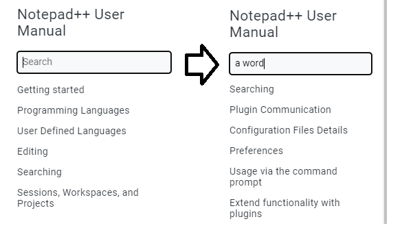

        The search feature isn’t great; it’s what comes bundled with hugo (the templating system we use for the usermanual). But it is okay for simple searches.
        When i try a word, I see the following:
        You will notice that the order of the table-of-contents changes – or, actually, all the matching pages come before “Getting started” (which scrolled beyond my screenshot).
        All the pages that it brings up before “Getting Started” are pages that the builtin search engine feels matches.
        So it’s working right now for me. But maybe 18 hours ago when you tried, there was a brief glitch on the server end.

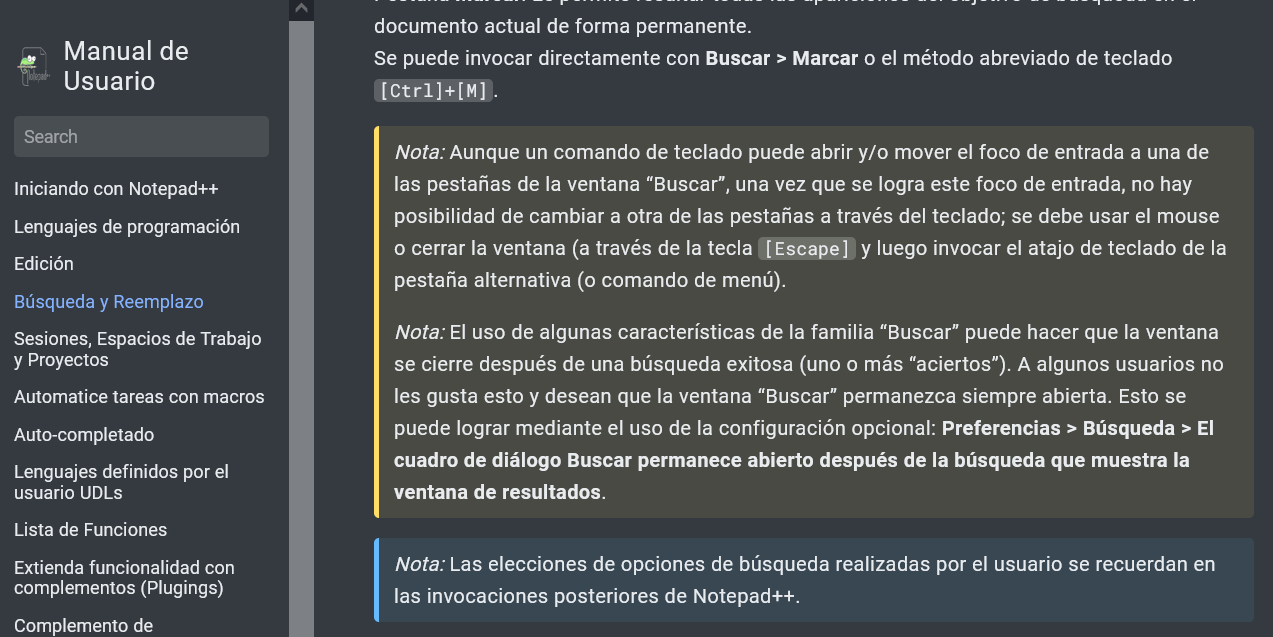

                  No rush, I’m experimenting with hugo, and I’m translating the content of hugo’s book theme, which has a nice demo inside it in a folder called exampleSite.
                  Hopefully I can help with something. For now I’m investigating how the search script.js and the content.json I mentioned earlier work.

                    Despite the use of BookSearch = true the search does not work for me
                    yet. Finally get the dark mode version of the manual. It can actually be auto depending on the browser configuration.

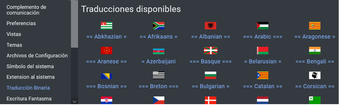

                                I tell you that I have the user manual translated into Spanish, and the only thing I need is to solve the search box. That I plan to maintain! if I CAN make it :) I send you a couple of snapshots.
                                I hope to be able to send it one day… You can see some innovations:
                                I managed to organize the flags in columns and alphabetically.
                                That’s why I do all these queries… But just like others I’m still raw with hugo site.
