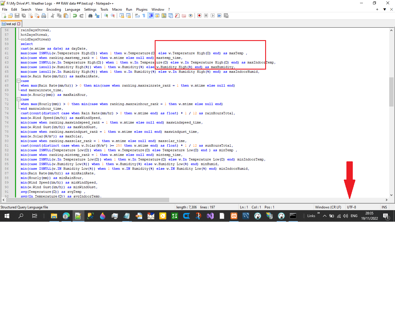

Hello
I believe I found a bug i notepad++. I have a file with degree symbol ℃ and metres squared W/m² and when I load this file into Notepad++ these characters display as garbage. Worse, if I then save this file in notepad++, the “garbage” characters are maintained and I can’t then use it (it’s a sql file). Notepad++ detects the character set utf8 and so this shouldn’t happen. Notepad displays and saves the characters fine.
I show the file below. save in notepad then load notepad++ to see the issue.

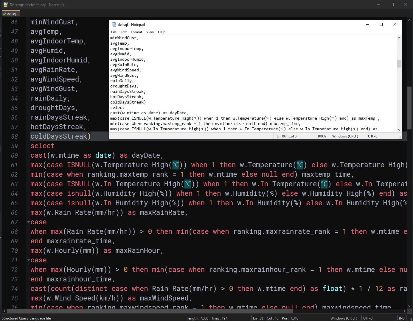

@Ekopalypse Hi there! What steps did you take? I copy/pasted the file’s text from what I posted back into Notepad++ then clicked save and got the garbage that I show in the screenshot.
My notepad version below. I don’t like how it says “ANSI codepage : 1252”. Does your Help->debug say similar?

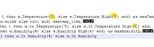

If I paste some of your data into a virgin Notepad++ setup, I see the same “box” displayed as you do.
However if I turn DirectWrite on in the Preferences > MISC. area and restart N++, all turns out well:
BTW, I don’t actually think you had an invalid file when the “box” was showing. The character was there, correctly; Notepad++ just couldn’t show it to you.
@Alan-Kilborn OMG well done!!! Fantastic discovery. All good now vis-a-vis Notepad++. I did indeed understand it was a display issue, because simple MS Notepad always shows it fine even after saving in notepad++.

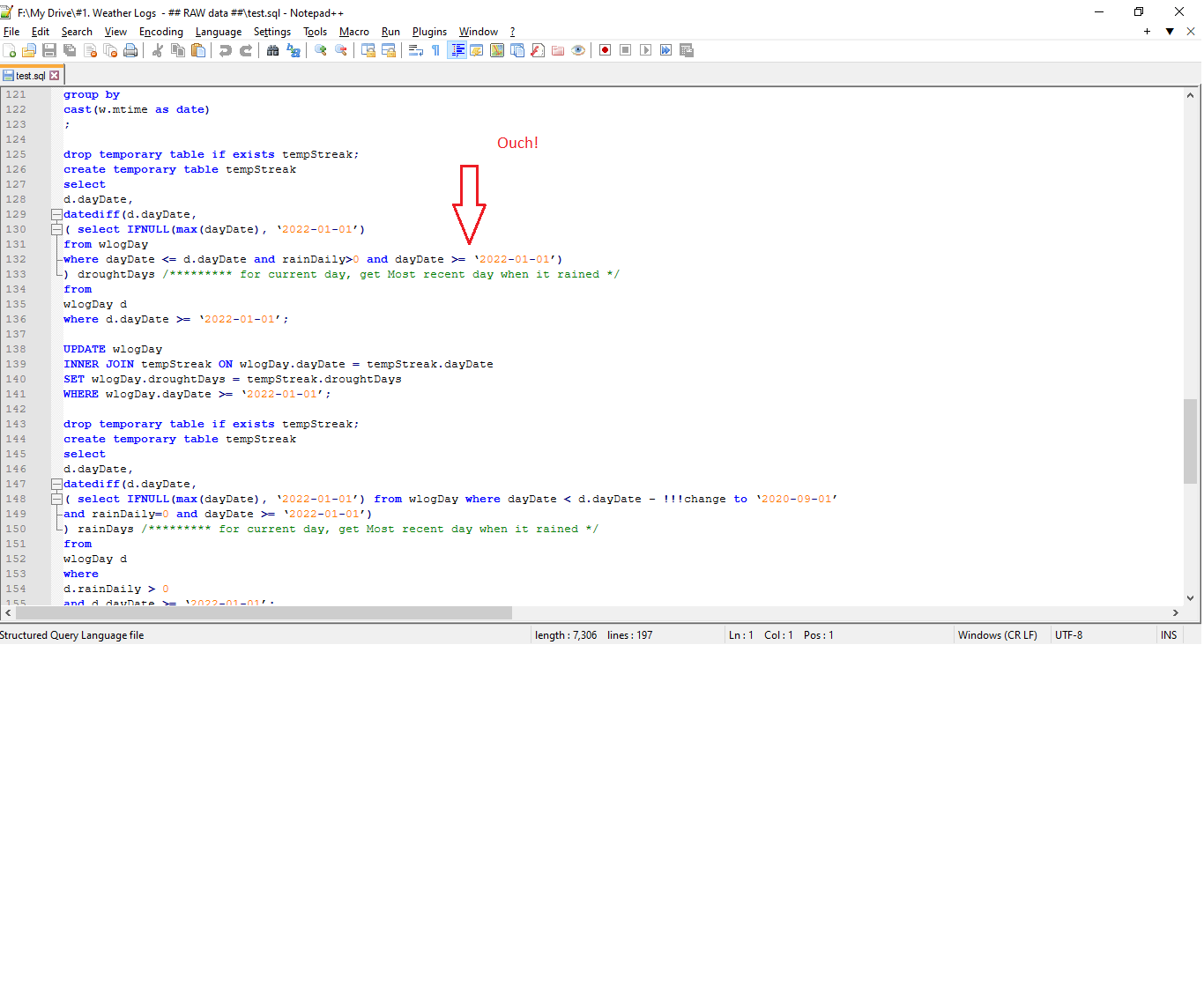

@Andrew-McP Alan, it didn’t work 100%, as it has converted all single quotes into smart quotes as shown (they look terrific but sql compilers dont appreciate beauty). Anyways, 15s and 2 global replaces later and all is good …thanks again.
@Andrew-McP said in BUG with characters in extended character set:
No, the forum converted all the single quotes into smart quotes, because when you pasted the original data into the forum, you didn’t use the
</>button on the toolbar to mark your text as “code” or “literal text”, as described in the Formatting Forum Posts FAQ. And when you copied the text back out of the forum, you copied the displayed smart-quotes instead of the original ASCII quotes.
