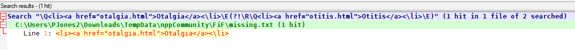

            FIND = \Q<li><a href="otalgia.html">Otalgia</a><\li>\E(?!\R\Q<li><a href="otitis.html">Otitis</a><\li>\E)
            This finds any file that has literal <li><a href="otalgia.html">Otalgia</a><\li> followed by a newline, not followed by literal <li><a href="otitis.html">Otitis</a><\li>
            I tried with two files,
            match.txt
            missing.txt
            <li><a href="outback.html">Outback</a><\li>
            with the results:
            it only “found” the file “missing.txt”, which had the Otaglia line without the Otitis line.
            Please note that I intentionally included your typo in my regex and the examples. I believe you will actually want to correct it to search for </li>, not the <\li> that you put in your most recent reply, but I decided to give you what you asked for.
