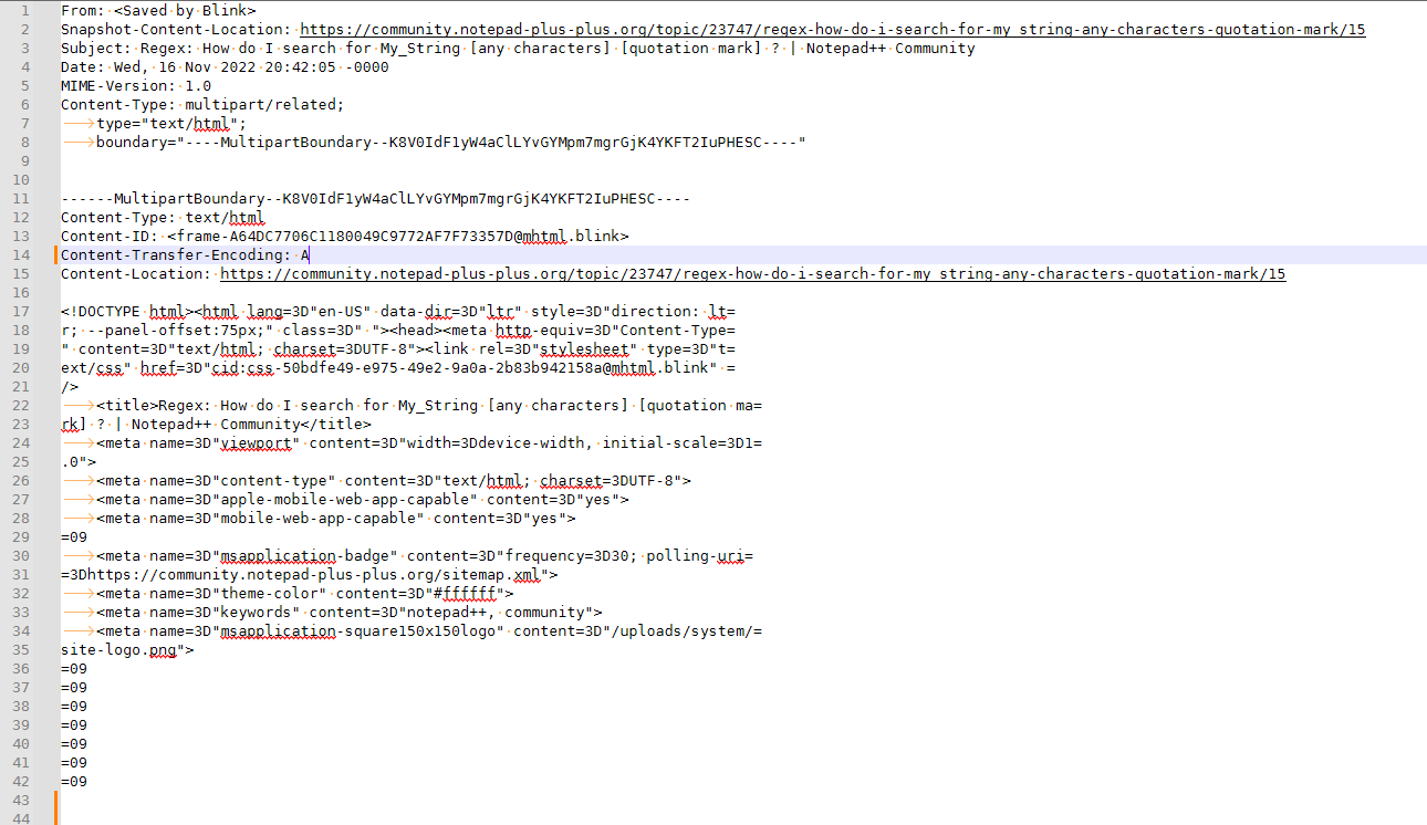

                                  PeterJones @IanSunlun
                                  @IanSunlun ,
                                  Wait, 72 character line length and = ending a line. I think your .mhtml might be using Quoted Printable. The = at the end of a line does have a meaning in QP.
                                  You really need to learn the file types you are editing before you start hacking around at things willy-nilly. Good luck getting that .mhtml to work right after all your edits.
                                  IanSunlunI 1 Reply Last reply Reply Quote 1
                                  • IanSunlunI Offline
                                    IanSunlun @PeterJones
                                    I’m trying to download my website for offline viewing. I downloaded .mhtml files. There seemed to be no other option for .mhtml saving - the default seems to have been this Quoted Printable format you mentioned.
                                    I took out all the =\r\n episodes in all the .mhtml files and loaded them back into my browser.
                                    Nothing seems to have changed. Its browsing and viewing them all fine. Now my other search and replace tasks will be easier.
                                    All I am needing is offline browsing.
                                      @IanSunlun ,
                                      I just checked; yes, saving a webpage as .mhtml from a major browser will use quoted-printable.
                                      If you really want to correctly do this:
                                      1. Select one part (the HTML part of the multipart, for example)
                                      2. Plugins > MIME Tools > Quoted Printable Decode
                                      3. Do your search/replace
                                      4. Select all that text again
                                      5. Plugins > MIME Tools > Quoted Printable Encode
                                      You will find it’s much easier to work with that way.
