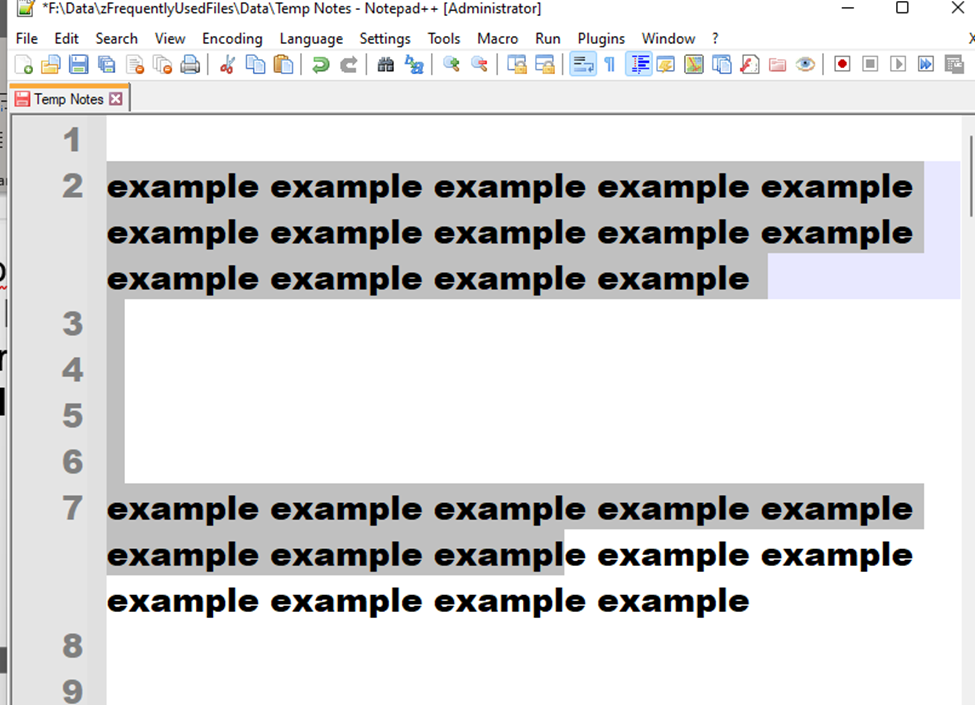

          In the following example, when I put the cursor in the middle of the second paragraph and press Ctrl + Shift + Up to select the text up until the start of the second paragraph, the first paragraph is also selected. This does not happen in other word-editing applications. Is it possible to select only the text within the paragraph where the cursor is currently placed?
            PeterJones @Влад Котенко
            @Влад-Котенко ,
            That’s because each “paragraph” that you show is only one line long – just a wrapped line. Shift+HOME (you might have to do it twice, depending on where on the wrapped line you are) will select to the beginning of the current line.
            In the example screenshots below, if you put the cursor in the indicated place on line 3, the SCI_PARAUPEXTEND will extend the selection to the beginning of line 1, because line 3 is only one line long:
            But if you put it on line 6, then because the paragraph has multiple lines, the SCI_PARAUPEXTEND will go to the beginning of what you consider the current paragraph.
            So, if you are in situation like the line3 example, if you use your re-mapped Ctrl+Shift+Up and it goes too far, just use the Ctrl+Shift+Down immediately after, and it will reduce the selection by one paragraph, so it will be down to the selection you want:
