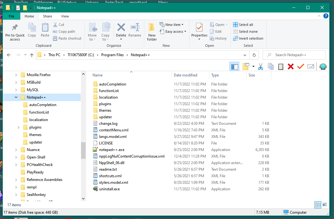

      The problem is I built a standalone installer to install those files in those directories, and even with the latest 8.4.6 installer version, those dirctories are not in the installation. These screenshots show the directories as they are on a virgin install before anything has been done after install.
      Here, the functionList directory is installed in the Program Files directory rather than the AppData\Notepad++\ directory.

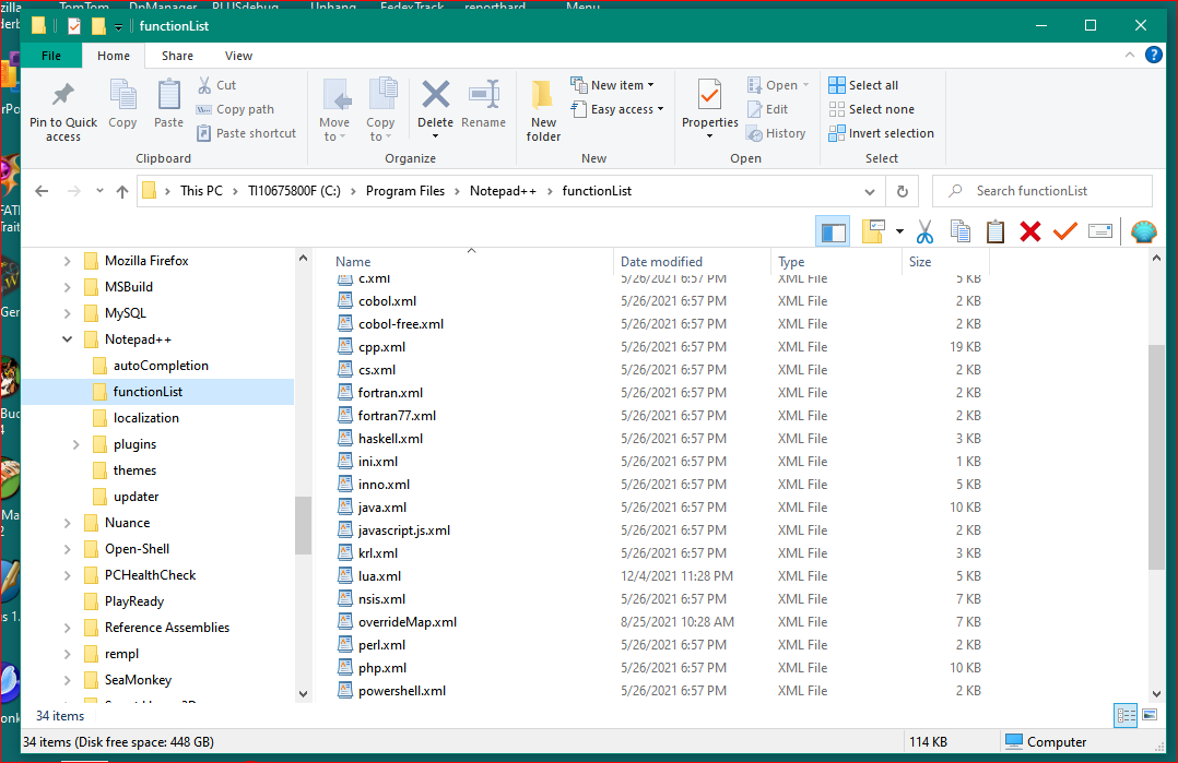

      Here the overrideMap.xml file is here instead of in the AppData\Notepad++\functionList directory.

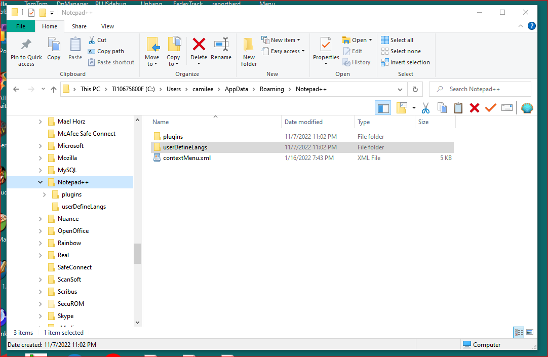

      Here in the AppData\Notepad++\ directory, there is no functionList directory to hold new functionList parse files, nor the overrideMap.xml file that is supposed to be in there with it.

          Notepad++ installs the bundled functionList files in the installation hierarchy. And then you create the AppData functionList directory to put any local definitions or edited versions of builtin definitions. When Notepad++ goes looking for functionList definitions, it will check AppData first: if it finds a matching definition, it uses that; otherwise, it checks the installation directory.
          So both are true: the ones that ship with Notepad++ can happily live in the installation hierarchy; and the ones you create can happily live in the appdata hierarchy.

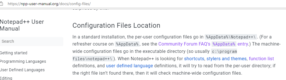

              @Lycan-Thrope ,

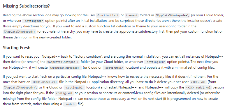

              For future reference, this priority is described in the manual:

                  @Lycan-Thrope said in New NPP Install issues for UDL features install:
                  That’s where I thought I read that, of course, there was no mention of having to make that directory to mimic the system one, so it was a guess on my part plus I remember you saying to someone else to copy that directory into the AppData heirarchy.
                  I am adding a few new paragraphs in that section:

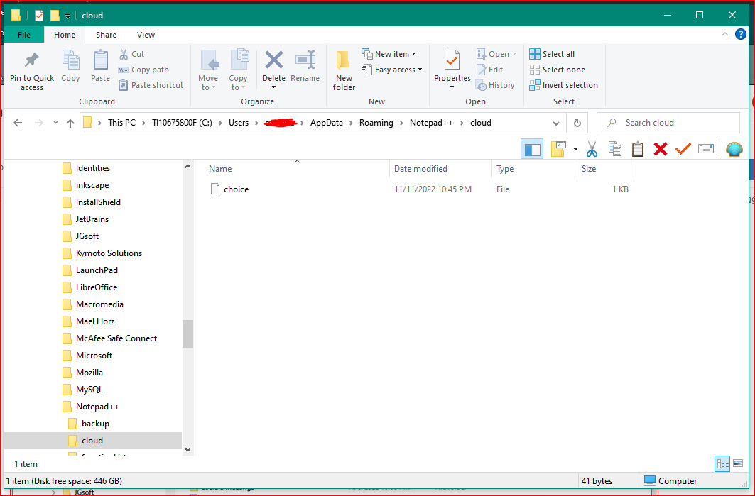

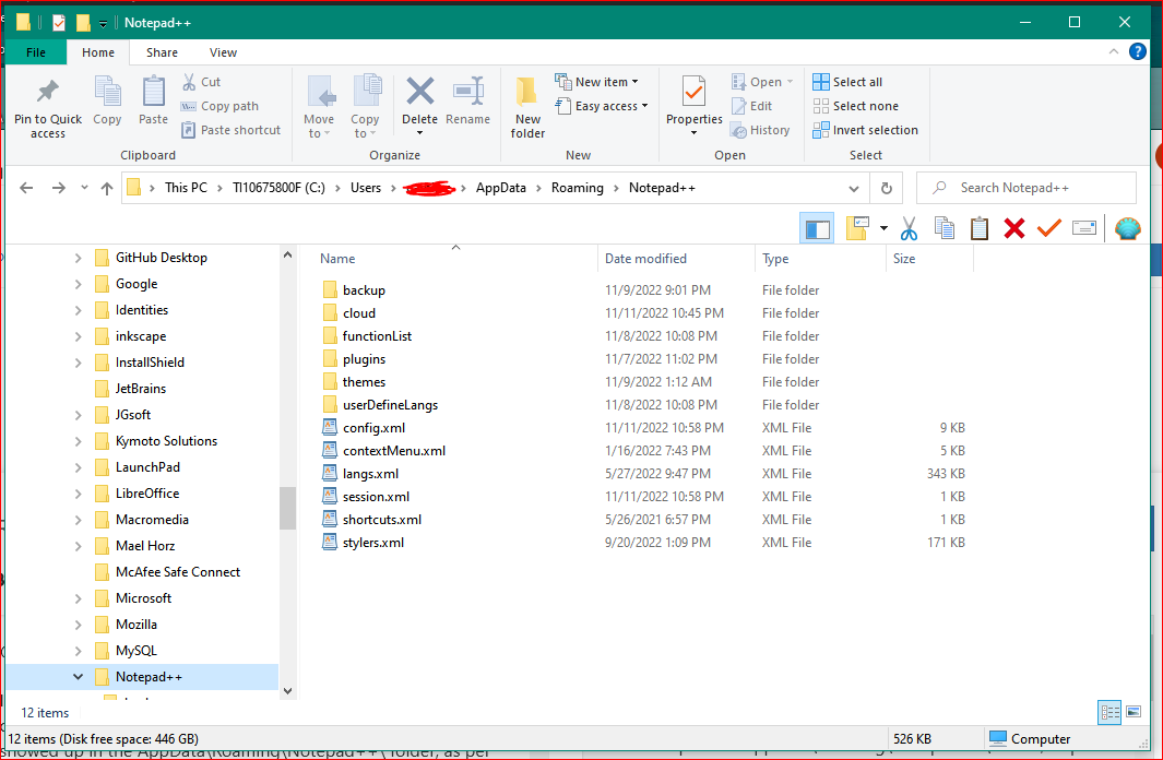

                          I was trying the Cloud setting, and I found that it didn’t create the cloud\choice directory and file in the install directory, it actually showed up in the AppData\Roaming\Notepad++\ folder, as per this screenshot.
                          And the file in this directory per this screenshot:

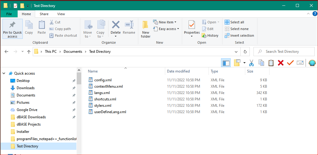

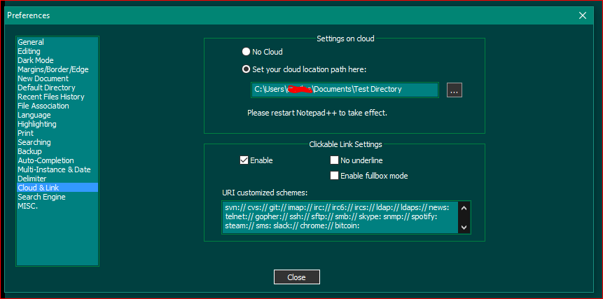

                          Just want to clear up and/or clarify what just happened. All I did was click the setting for the cloud here and selected a directory for it to put the files into that could represent a cloud directory as in this screenshot:
                          Then after closing NPP, this directory filled itself with the config files that the AppData\Roaming\Notepad++\cloud\choice file pointed to as shown in this screenshot:

                              PeterJones @Lycan Thrope
                              @Lycan-Thrope ,
                              You appear to be right.
                              I guess I had only experimented with local-config Notepad++ instances, or something changed.

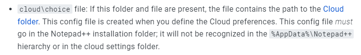

                              The next edition of the User Manual will say,
                              • cloud\choice file: If this folder and file are present, the file contains the path to the Cloud folder. This config file is created when you define the Cloud preferences. If you are in a normal installation, this config file will be %AppData%\Notepad++\cloud\choice; if it is deleted from there, Notepad++ will not look for <installdir>\cloud\choice. If you are in a portable / local configuration (doLocalConf.xml exists), it will be in <portable>\cloud\choice.
