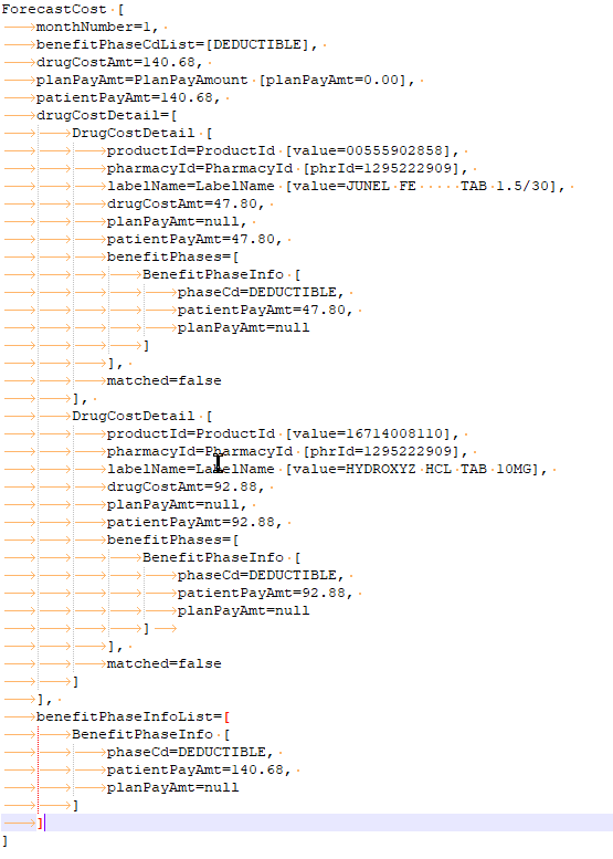

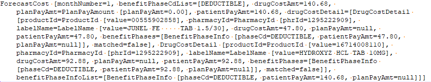

      I have some java debugging that looks like this:
      And I’d like it to look like this:
      I’ve looked at creating a new UDL but it’s not quite made the connection in my mind. If anyone has a link to something similar that I could base this on that would be appreciated.
      Or any other help - this is basically just a formatting issue, there are no real keywords to find/highlight/etc.
      Your thoughts are very much appreciated.
        PeterJones @Ken Weinert
        @Ken-Weinert ,
        UDLs are for syntax highlighting (defining keywords, and having Notepad++ show the text in different colors depending on those keywords and the styler settings).
        The change you showed was more of a “pretty print” feature, which doesn’t exist in Notepad++, for any languages. Some languages have plugins which will do a pretty print (such as XML and HTML and JSON). But Notepad++ doesn’t have that feature natively, so Notepad++ has no way to automatically make the transformation for your particular language.
        You could try to develop a search-and-replace regular expression that might be able to handle it – but it would be rather complicated (I just spent 5-10 minutes, but couldn’t even come up with a multistep sequence that did something reasonable.)
