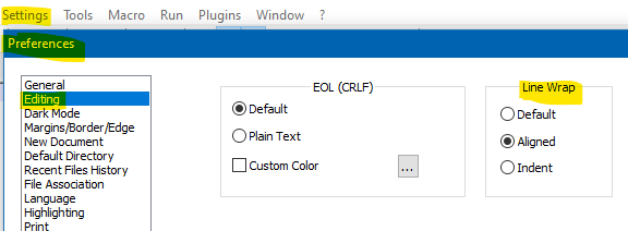

        Alan Kilborn @Zaine Pittman
        @Zaine-Pittman
        Your choices for controlling this behavior are here:
        And HERE is your user manual reference.

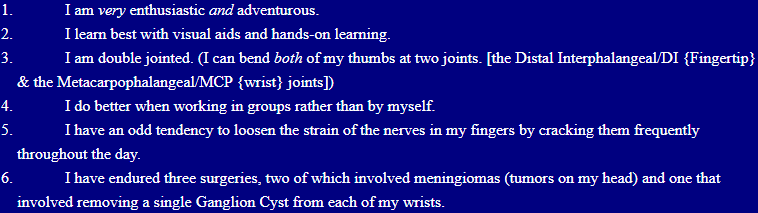

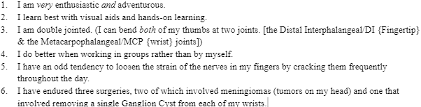

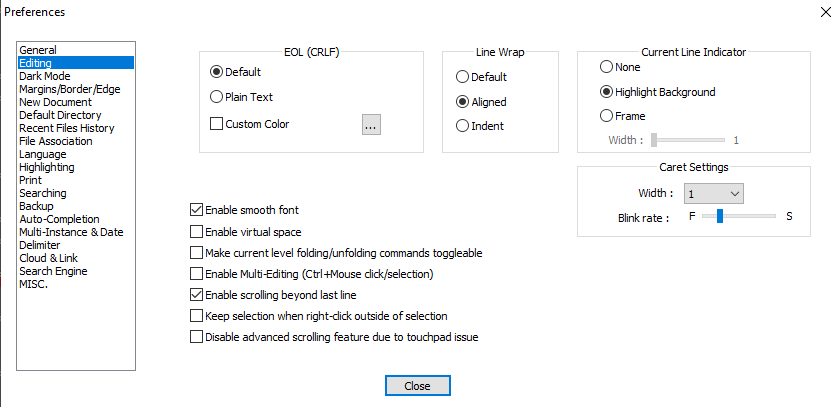

          @Alan-Kilborn Ok, I have those settings enabled, but I’m still left with the same pattern that the snapshot with blue background is. I have included three images, one being what the lists on my webpage look like (top), one that shows the settings enabled on my Notepad++ (bottom), and the third showing what I want my website’s lists to look like (middle).! What_My_Lists_Look_Like.png What_I_Want_My_Lists_To_Look_Like.png The_Settings_Enabled.png
            @Zaine-Pittman said in List Flushing:
            I wasn’t telling you to enable a certain setting, sorry if I didn’t make that clear. I was merely pointing you to the possible options you have for controlling the indention view of wrapped lines.
            You should try each of the 3 settings in the Line Wrap box to see what works best for you.
            I’m not saying you can achieve what you want, but these are the only options available.

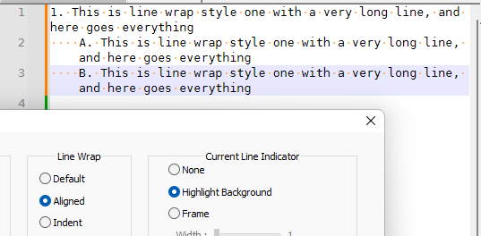

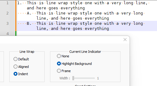

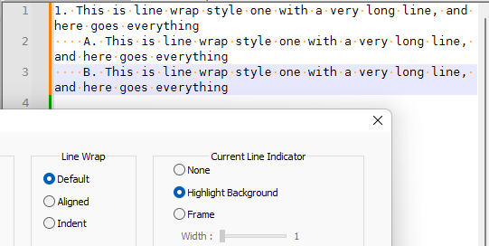

                PeterJones @Zaine Pittman
                @Zaine-Pittman ,
                “Default” and “Aligned” look the same if all the bullet items are at the same indent level. They only show differences if you have multiple levels of indent.
                The following text, with a narrow window
                1. This is line wrap style one with a very long line, and here goes everything
                    A. This is line wrap style one with a very long line, and here goes everything
                    B. This is line wrap style one with a very long line, and here goes everything
                will look like the following three screeshots in the three modes:
                • DEFAULT: every wrap goes back to column 1:
                • ALIGNED: every line wraps to the first non-whitespace character, so the 1-line wraps to column 1, the A and B lines wrap to the start of the A and B:

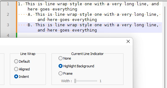

                • INDENT: every line wraps in to the next indent location:
                  – since my tabstops are set at four characters, it indents four characters from the A or B
                  – if I had used two spaces (or hit TAB) between the A. and the start of the text, and between the 1. and the start of the text, then everything would line up “flush” like Google Docs or MS Word
                  – This is pretty nice behavior, despite the fact that those are full-featured Word Processors, and this is only a Text Editor: in other words, Notepad++ is going above-and-beyond the call of duty for word-wrap presentation in a text editor, giving you lots of choices for aligning bulleted lists.
