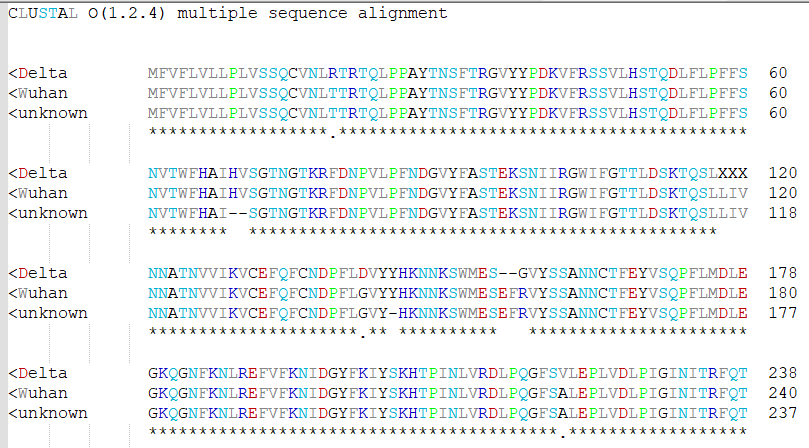

      I thought it would be fun to make a lexer for colorizing protein sequences according to amino acid properties, and the current UDL system doesn’t seem well-suited for this. So I used PythonScript!
      See https://github.com/molsonkiko/NPP_protein_lexer and maybe submit a pull request if you have an idea of how to improve it.

          • Mark OlsonM Offline
            Mark Olson @Alan Kilborn
            I wasn’t really familiar with EnhanceAnyLexer prior to making this script, but now that I’ve tried it out this is actually really simple!
            Just need to create a lexer called protein with white text background, install the plugin and add this to EnhanceAnyLexerConfig.ini
            [protein]
            ; default (black)
            0x000000 = [^DEPHKRNQSTILMFWVACGY]
            ; acidic (blue)
            0xbe0000 = [DE]
            ; cyclic (green)
            0x00f600 = P
            ; basic (red)
            0x0000be = [HKR]
            ; hydrophilic (cyan)
            0xb0d000 = [NQST]
            ; amphiphilic (orange)
            0x00b0d0 = [ACGY]
            ; lipophilic
            0x848484 = [ILMFWV]
            ; check in the respective styler xml if the following IDs are valid
            excluded_styles = 1,2,3,4,5,6,7,8,9,10,11,12,13,14,15,16,20,21,22,23
            and you get the same result, except better because amphiphilic amino acids are now orange.
