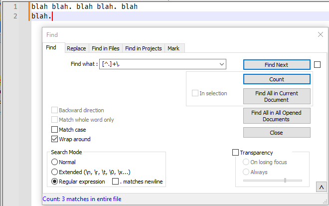

      Hello, I have some paragraphs (one paragraph in each separate text file). The files are numbered sequentially as p1,p2,p3, … I wish to count the number of sentences in each paragraph in these files and the number of words in each of these sentences. For example, paragraph p1 might have 3 sentences (identified by full stop at the end of each sentence). An the wordCount in these 3 sentences might be 10, 23, 16. How to go about counting and listing the number of these sentences and words in each of these sentences? If it can be done individually for each text file (paragraph) then also its ok. Thanks.
        Isn’t the number of “paragraphs” simply the number of files then?
        You could do it in ONE file like this (via the Count button), seeing the result on the status bar:

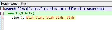

        To do multiple files you would switch to the Find in Files tab and run the same search against multiple files and obtain your count in Search results:
