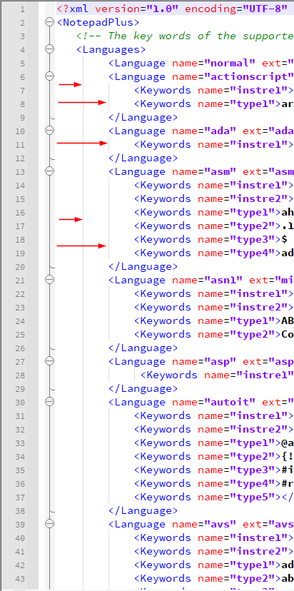

        Indent guides are vertical dotted lines that indicate the indent level of text in the edit window of Notepad++ (I’ve marked them with red arrows in the screenshot below):

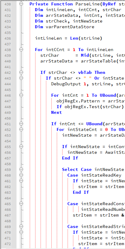

        Though they also show up in normal text files, they are most useful when displaying/editing source code of programs because they are “guiding” a programmer’s eyes from the statement opening a block of commands to the statement closing this block:

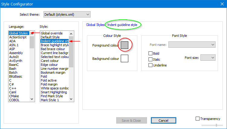

        As you can see in the screenshot above, I configured the color of indent guides to be red. This can be done in the Style Configurator dialog (navigate to (menu) Settings -> Style Configurator):
        When clicking the grey rectangle with the red circle around it from the screenshot above, you are able to configure the color of indent guide lines. In your installation they are most likely configured to be white (i.e. the same color as the background color), that’s the reason why they are invisible though (menu) View -> Show Symbol -> Show Indent Guide is checked.
