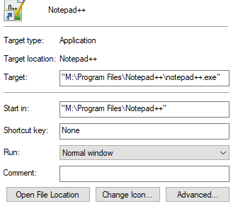

          @PeterJones doesn’t look like my shortcut is doing that but man i thought you had it

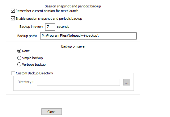

          Here’s my backup settings:

                  With local config mode, and the settings you are showing, your active session should be found in M:\Program Files\Notepad++\session.xml .
