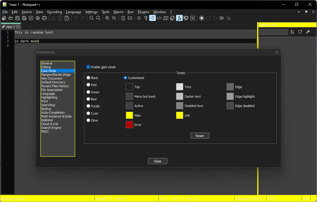

        PeterJones @Andi Kiissel
        @Andi-Kiissel ,
        In customized Dark Mode, it is controlled by the “Main” color when that pane is inactive, and “Active” when that pane is active.
        If you really wanted it light, but wanted to control the color, you might be able to set up a list of those 12 colors that would look like the original Light mode, but change the color of Main – though I am not sure you can 100% get back to light mode by just changing those 12 colors (and picking a light theme)… you can probably get close.

          Andi Kiissel @PeterJones
          @PeterJones ,
          Yes, clever approach, thanks!
          Unfortunately it’s impossible to set Light mode through Dark mode :-)
          Now I know that #99B4D1 is ActiveCaption system color in some themes since Windows Vista.
