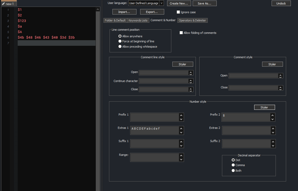

      I’m trying to create a UDL for a dialect of BASIC. This dialect uses the dollar sign as a prefix for hex numbers.
      In the Comment & Number section I have:
      Prefix 2: $
      Extras 2: A B C D E F a b c d e f
      However this only works for numbers like:
      $1
      $2
      $123
      These don’t work:
      $a
      $A
      $4b, $48, $46, $43, $40, $3d, $3b
      What am I missing here?
      Thanks

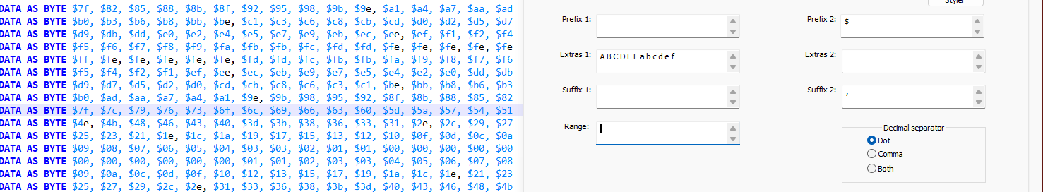

          Thanks, I’ve done that and added ‘,’ in Suffix 2 so that lists of numbers work, however it seems to be having an issue with the letter ‘e’ …

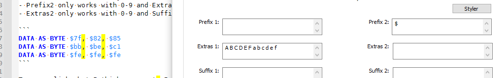

            Per documentation here:
            • Prefix1 and Suffix2 only work with 0-9
            • Prefix2 only works with 0-9 and Extras1
            • Extras2 only works with 0-9 and Suffix1
            To accomplish what I think you want, I would set
            • Prefix2 = $
            • Extras1 = A B C D E F a b c d e f
            • Operators1 = ,
            This will make the comma an operator which doesn’t require spaces. Since comma is an operator in BASIC, this seems reasonable to me. And it allows the comma to be a list separator inside your list of hex numbers
            DATA AS BYTE $7f, $82, $85
            DATA AS BYTE $bb, $be, $c1
            DATA AS BYTE $fe, $fe, $fe
