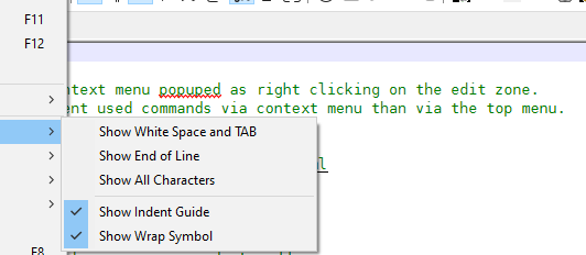

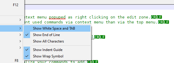

      I used the pretty print from the XML Tools to view my XML file, but I also see the CRLF at the end of each line and I do not want that. How do I fix this in preferences or setting?
        PeterJones @Kavita Shetty
        @Kavita-Shetty
        View > Show Symbol sub-menu. If you re-click the one that is checkmarked, that will be disabled; if you click a different one, the checkmark will move from the old to the new.
