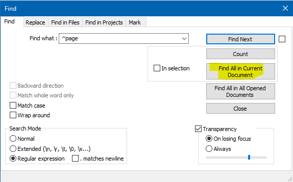

        You could do a Find All in Current Document search for ^page in Regular expression search mode:

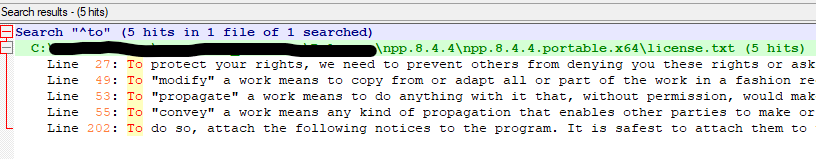

        This would get your desired lines appearing in the Search results window, which provides double-click jumping to the source line. Here’s an example (I changed search to ^to to search N++'s license.txt file):
        And i need to see on my left side these lines as gathered list
        The Search results window appears by default on the bottom, but it can be undocked and moved where you like.
