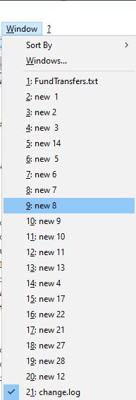

            Here’s what I see in NotePad++ 8.4.4. after I press <ALT> - W and type “9”:
              Alan Kilborn @Master VB Guru
              @Master-VB-Guru
              From your screenshot, there are 2 possibilities for 9 in your list, 9: new 8 and 19: new 28. Since Notepad++ doesn’t know which you intend, it is waiting for you to either press 9 a second time (to move the selection highlight to new 28) or press Enter (to activate new 8).

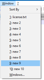

                @Master-VB-Guru
                Note that in earlier versions, e.g. 8.4.2 as you suggest, there are only unique choices for 1,2,3,4,5,6,7,8,9,0 as a maximum of 10 files is presented, and thus the Enter press is not necessary to activate one of them:
                And still in 8.4.4, if one has ten or fewer open tabs it will not require the additional Enter press, as Peter’s trial earlier shows.
