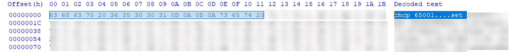

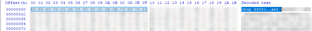

      So what I’m guessing is that when using regex to create one more line with \n the app only writes 0A but I’m not sure about that as not all the lines had been created with regex, unfortunately I can’t share the files because they contain private data but I can share a part of the hex values (replacing the 0A with 0D 0A fixes this problem:
      PROBLEM-FREE FILE:
      PROBLEMATIC FILE:

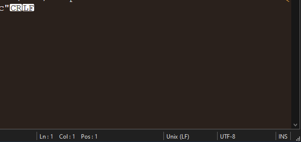

            @Ekopalypse I just noticed this:
            Could this be the problem? The file has Windows line terminations but for some reason Notepad++ has detected that the file has Unix terminations.
              PeterJones @Carmak Cusac
              @Carmak-Cusac said in Npp++ sometimes makes weird line terminations:
              for some reason
              yes. That reason is that the first line had just LF, because, as @Ekopalypse said, “Scintilla reads the first line to determine which eol is being used”
              The easiest way to fix it is to right-click on the Unix (LF) on the status bar and select a different option (like Windows (CRLF), which will convert all the lone LF to CRLF). If you really wanted Windows EOL, then leave it there; if you really wanted Unix EOL, then change it back to Unix (LF) through right clicking there again.
