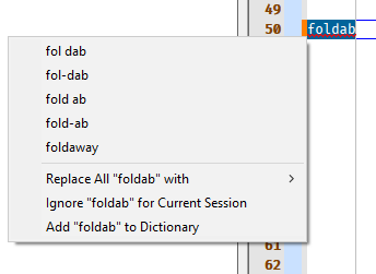

            I do however, see a “drop arrow” when I hover over a misspelled word:
            Clicking that, I get a popup menu with the relevant choices:

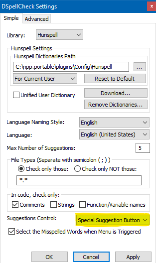

            I notice in the “DSpellCheck Settings” that the drop-arrow is called the “Special Suggestion Button”:
            and that it is a choice between that and “Use N++ Context Menu”.
            Peter must have the N++ context menu choice active.
